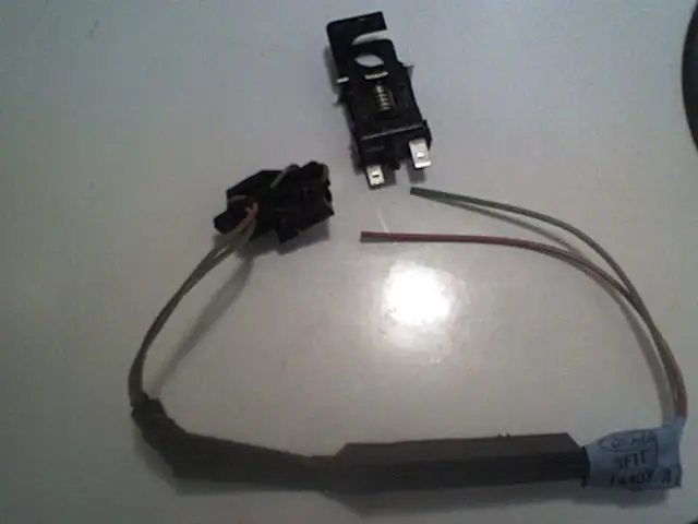

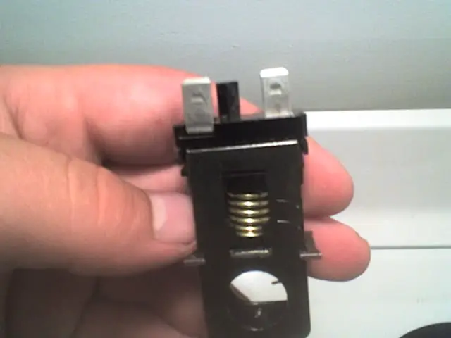

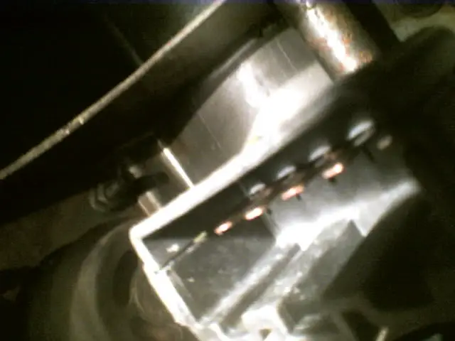

So I go down to Autozone and give my information and I get what I believe is the right part, only to see that it is not the right one when I get back. The part I need has 4 prongs in a row where as this one has 3 in a 2 and 1 format.

I took some pictures of what they sold me, and what my brake light switch looks like.
Here's the entire product they gave me
Here's what the thing looks like up close
Here's what MINE looks like
Here's what the plug looks like up close (or as best as I can get)

jumper pins 4 and 5 (LG/RD, LG) on the connector and check your brake lights. if lights come on you have a bad switch. if they don't come on, check for power on LG/RD wire (fuse #13 20amp).
switch is a Brake Pedal Position Switch

i show F87Z13480AA as the ford part number.
give them a call, they may have to order it.
Wow thanks a lot, rockauto and autozone both do not show that as the switch I need but that IS it! Its under Rock Auto as a Brake Light Fail Switch. Thanks a lot GREATLY appreciate it! :thumbsup:
