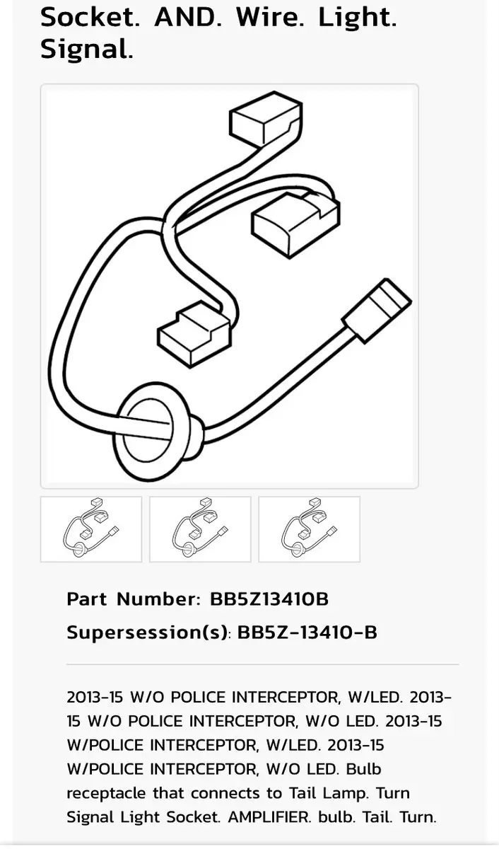

So update, today on shift at the FD I had a free moment to dig into this issue a little bit. I’ve tried disconnecting one tail light assembly at a time to see if it changed anything and unfortunately it did not. I pulled the inner panel off of the lift gate as well to check all wires and connectors coming from the high level brake light with no difference either. No indications of water coming in and no exposed wires. Since I’ve eliminated the theory of water in the tail light assemblies and high level brake light could there possibly be water getting into the fuse panel up under the steering wheel close to the firewall creating a short between the headlights and brake light relays? I’m at a loss right now.
UPDATE UPDATE UPDATE!!!
I took it to a local shop that specializes in being electrical wizards and have found the issue. I had a bad connector. New harness in and everything works as it should.
Almost $400 for diagnostic testing parts and labor.
Ford Part number: BB5Z13410B.
