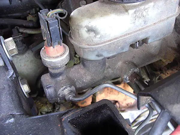

I dont have the exact size but I also couldn't find a replacement so I ended up re-using the fitting itself -- I just slipped it over another re-flared section of steel brake line tubing.

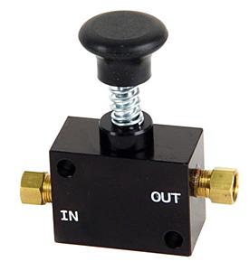

Along with the cutting brakes, I'll be putting this in and ditching the useless mechanical e-brake.
