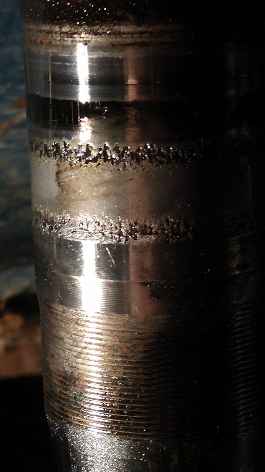

The seal shouldn't leak if it's not old(hard), and the axle surfaces are smooth for both the seal and bearings. If you did it already, than maybe the seal got nicked or damaged at some point, and a new seal shouldn't do that again. It sounds like the axle needs to come back out, and look everything over again, replacing the seal at least.
Any small deformation in the running face of the shaft may cause a new seal to leak.
You would be surprised what rubber can do to a steel shaft.
Are there any grooves or notches on the face of the axle shaft that you could hang a finger nail on?
Can you post a picture?

I'll be pull in the axle and putting a new seal on in the next few days. Have had nothing but overtime at work the last week so have had no time to tackle.
I'll post pics of axle shaft then. I'm going to Go to pick a part this weekend regardless and bringing home the prettiest axle shaft I pull out of the 9 first gen explorers that are there. I think come spring I'm going to swap the back end out for a second gen (?) rear end with disc brakes. I can handle from brake work but I really don't like it. If I can go all disc in gonna. Thanks again for all the replies and input guys.

you can also get a speedy sleeve for the seal wear part of the axle. the sleeve is so thin that it won't harm the seal for being so tight very thin.
roscoe
Funny you suggest that as I just talked to my parts guy and he said he could find a sleeve on each side of the size I need but not the right size.
