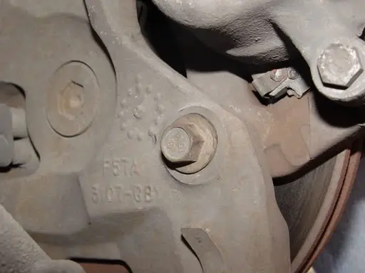

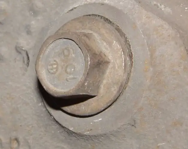

there's the culprit! That's one of the caliper bolts (the bottom one) from the inside of the control arm. It had worked itself loose enough for the bottom of the caliper to slide about 1.5-2mm or so when the pads gripped the rotor. I guess it happened since I did the brakes last b/c I didn't use a threadlocker. A little loc-tite on that sucker and it isn't going anywhere now! :D
