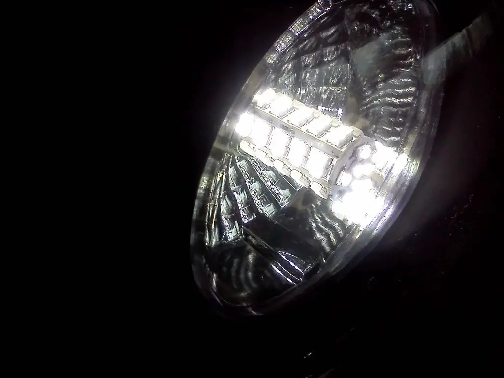

I found these on eBay and they're #%($# bright. I found these when thinking of ways to cool off the sockets. Incandescent/halogen fail. LED bulbs run cool. After trial and error, I found these. I did a search on eBay for "3156 white 68 smd" without the quotes, and ended up with a spaceship style of super white.

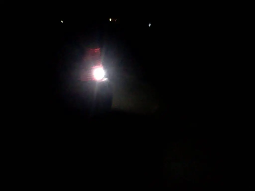

Here is the side, followed by the rear. These were taken by a crappy camera.

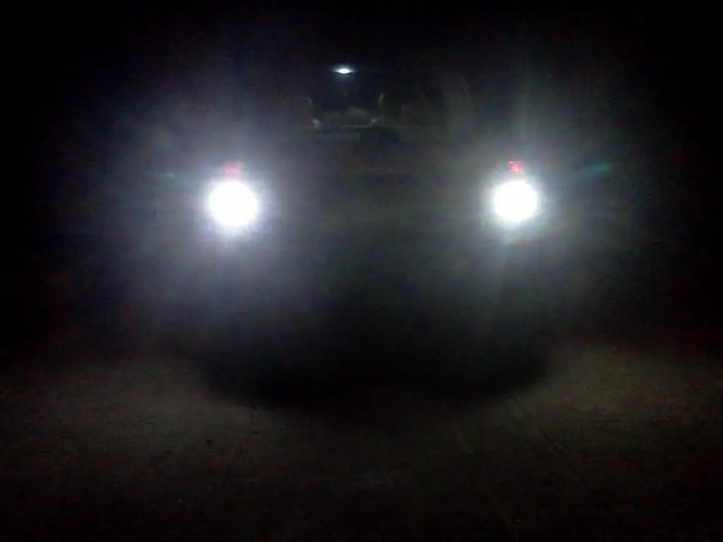

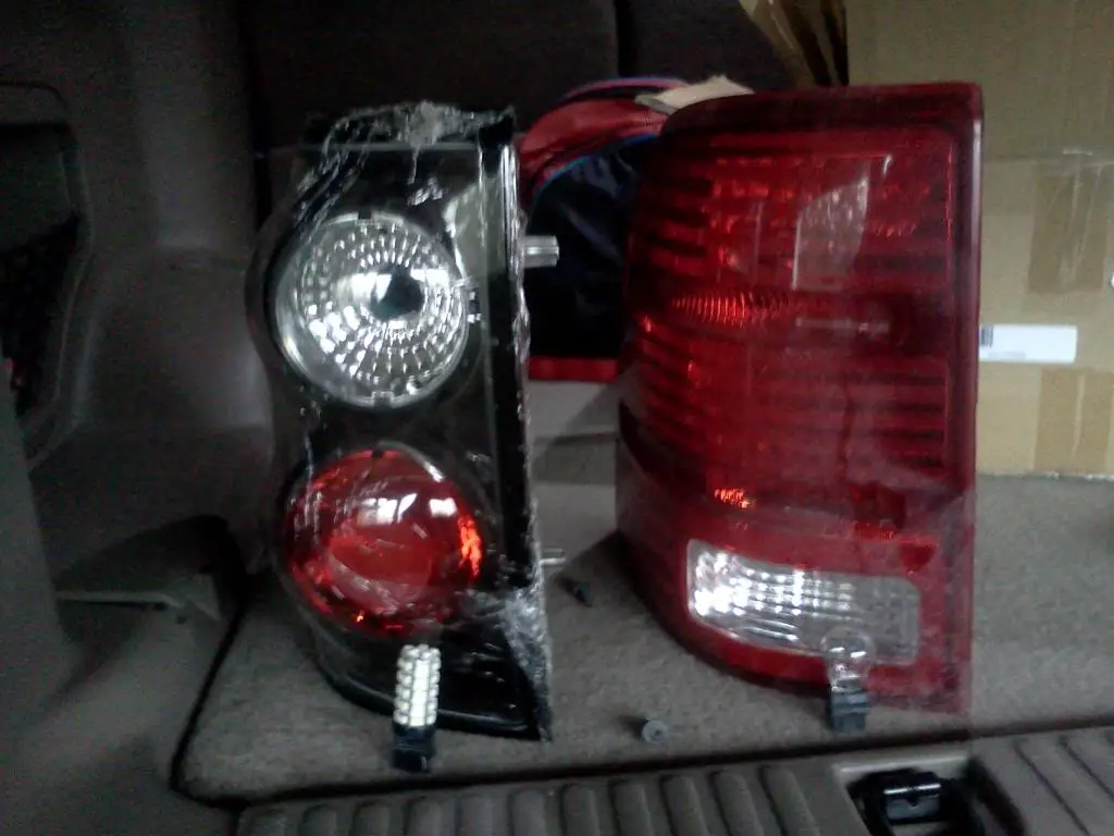

Here is what they look like. The first picture is factory lenses.
This one is my Altezza lenses, which make them a gazillion percent brighter, and you can see exactly what it looks like.
