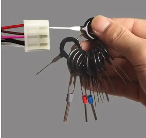

Ford connectors can also be depinned and rebuilt. This video is a good guide:
