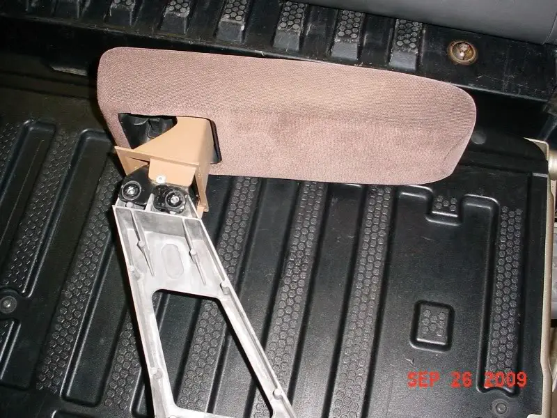

Bronco II or earlier model Explorer will work. It's a little bit shorter but much much stronger. Believe me it works great. I paid about $20 for the whole armrest. It was nasty and green from being in the weather but I scrubbed it and rinsed it with the garden hose and it's as good as new. It's a shade lighter than my seats but I really don't care. Beats spending a chunk on something that will break again! The dark spots on the arm rest are from it still being damp when I installed it.

That armrest mounting bracket pattern goes all the way back to the '85 Bronco II, which is why I recognized it. Any Bronco II or Explorer that has the folding armrest like the one in my photo will work.

Is it on the short console as pictured above or on the full length console?
