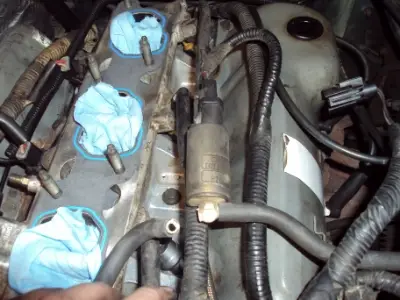

Yeah, above is a picture of where I broke mine... right at the purge valve. I had to get a new valve. The original line has an elbow piece that attached to the TB. I pulled that off and tossed the rest of the line. I then got a piece of 1/4" fuel hose, clamped one end to the new valve and the other end to the elbow, then reattached to the TB.
I also replaced the section of line that goes from the valve to the canister with 1/4" fuel hose. The original line is really tight and I was afraid to force the valve connectors in and risk breaking them again.
I clamped one end to the valve, and the other end to a coupler. I then attached the coupler to a portion of hose that was solid on the canister.
yep that exactly how mine broke. lol at first i was like how did that guy get a pic of my engine???????

I was able to use some needle nose pliers to pull that broken white piece out, but I felt like I about tore a bicep doing it. Heh. Then when I tried to plug the new one back in it was just taking too much force. I got very nervous. So I went with the fuel hose. It snugs in pretty decent, and then I snugged it down a bit further with a clamp.
