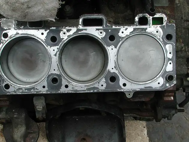

If I was in your situation I would at least take the valve covers off and take a look before making any major decisions in what steps to take next. If the valve stems and associated hardware seem ok, replace the primary chain, set the timing and turn her over by hand nice and gentle. If its still seems ok, I'd compression check the cylinders this will give you a good indication of how the valves are seating. If the compression is "ok" over the 6 pots, I'd put her back together and fire her up.

A possible alternative to pulling the valve covers and checking for valves that won't seat is to borrow an inspection camera/viewer.
Digital Inspection Camera
Pull the spark plugs and look at the pistons thru the plug ports. If the pistons have struck the valves it should be obvious.

Doesn't sound too bad. It would have lost oil pressure strait away with the oil pump being driven by the jack shaft. I would deffinately compression check it before removing the heads to repair valves thay (may be) damaged. Might be lucky with this one.;)
I personaly would run dinged pistons but never cracked ones. Cam gear and shafts should be ok but I would check over them to make sure a rocker arm has not become dislodged or something.
