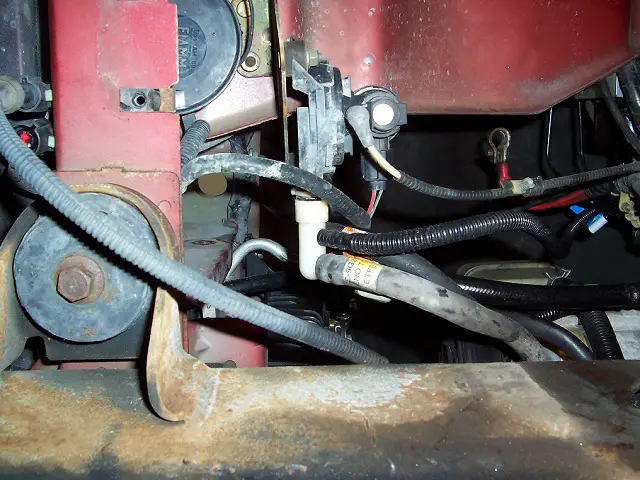

Thank you for your reply. I have a Haynes manual which is about as much use as a paper teapot but I can see the line in question in your picture. It is directly below the large connector with the nut on it and heads south off the image which is where I need to know where it ends up.
Dave
Thank you for your reply and I am looking at position 4 on the picture
4. bottom left: (splits into three lines with two lines splitting again into two) fuel pressure damper, EGR vacuum regulator, evaporative emission canister purge valve, vacuum reservoir bulb below air filter enclosure
The mystery deepens as the line would appear to head in the general direction of the EVAP canister purge valve, however the valve only has two vapor lines and an electrical connection so I wonder if the original poster made a mistake with that.

The EVAP canister purge valve is located above the fuel tank on my Sport. I suspect that is the disconnected hose. It runs under the 4WABS and then aft under the body. The fuel vapor management valve is located below the battery tray.
I think that is what you're referring to in your post. The hose to it comes from the lower front of the engine.
Ahh, that makes sense I was confusing those two items. I have already looked under the front and not found the broken hose so it looks like it might be easier to start at the back and trace it to the front. I am out and about all day but first thing Sunday I will get under the car and report back.

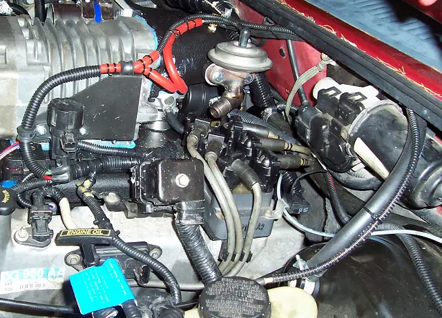

You should be able to see the EVAP canister purge valve hose by looking into the engine compartment. It may be the one in the photo below.
The vertical one below the brake master cylinder that turns forward and goes under the battery tray. When I added my supercharger I routed the hose from the plenum along the hose going to the master cylinder booster.
