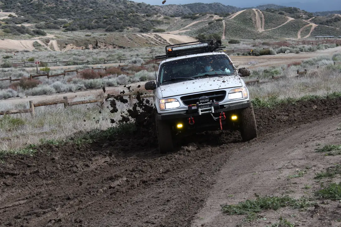

I did it because of the attatched image haha its fun in 2wd
Also its helpful sometimes if Im on the ramp in 4L (if its wet/slippery) and I need to turn, I can put it in 2L just to turn then back to 4L

Yes if you want to do a burnout it will send power to the front without the BWM (meaning no burnout without the BWM)
