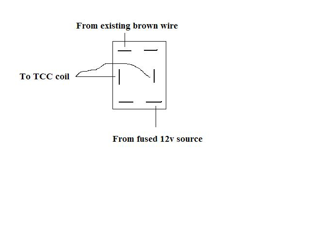

However, in the meantime, I took a look at the GEM/TCSM/TOD/TCSR schematic (which I have attached below for reference). As a retired electronic engineer, albeit not automotive, something the OP said, despite an otherwise wonderfully helpful post, didn’t ring true:
Now, please note that the TOD relay is either on or off, and the Transfer Case Clutch is either engaged or disengaged. The relay and GEM do not vary the amount of power applied to the transfer case, they simply vary the DUTY CYCLE of the TCC. The transfer case is either engaged or disengaged at any given moment.
When you select 4 high from the switch on the dash, the GEM sends the signal to the Transfer Case Shift Relay to engage 4 high. This sends power directly to the Transfer Case Clutch Coil, essentially a 100% duty cycle.
When I first read this, I thought “why wouldn’t the designer use the same device (TOD) to generate the 100% duty cycle required for 4WD as is used to generate the lower duty cycle signal for 4WD-Auto?”
And as it turns out, he did. Although the Transfer Case Shift Relay (TCSR) does connect to the Brown Wire (see schematic), it’s sole purpose is to clamp the BW voltage so that it doesn’t go significantly below Ground (0V). That’s the function of the diode from Ground at TCSR-pin7 to Brown Wire at TCSR-pin 6. The TCSR is not capable of putting a high voltage (that is, 12V) on the BW. So why does it need to clamp the BW? Since the Transfer Case Clutch Coil (TCCC) is an inductor, it wants to continue drawing current out of the BW when the TOD has switched off. That current has to come from somewhere other than TOD – so it’s pulled through the diode. If the diode wasn’t there, there is the potential of damaging the TOD by creating a very large negative voltage spike on the BW.

Just thinking about this one.... if you insert the BWM switch between the TOD relay and the splice, then yes, 4high and 4low will act as normal even with the switch off. If you insert the switch between the splice and the TCCC, the system will not and cannot lock the two driveshafts together if the BWM switch is off. Transfer case range selection is otherwise unaffected.
-Joe
It doesn’t matter whether you break the BW before or after the spice as long as it’s somewhere on the path between the TOD and the TCCC. The controlling signal (from the TOD) will be interrupted and the Transfer Case will be in 2WD regardless of panel switch position. I confirmed this by cutting the BW between the TOD and the splice and observing that when the panel switch was moved from 4WD-Auto to 4WD that 1) 4WD was not activated, 2) the BW segment going to the TCCC had 0V (even though it was still connected to the TCSR, and 3) the BW segment connected to the TOD jumped from its nominal value up to around 6V as measured by my voltmeter. Note that it does not jump to 100% in any case, as far as I can tell.
