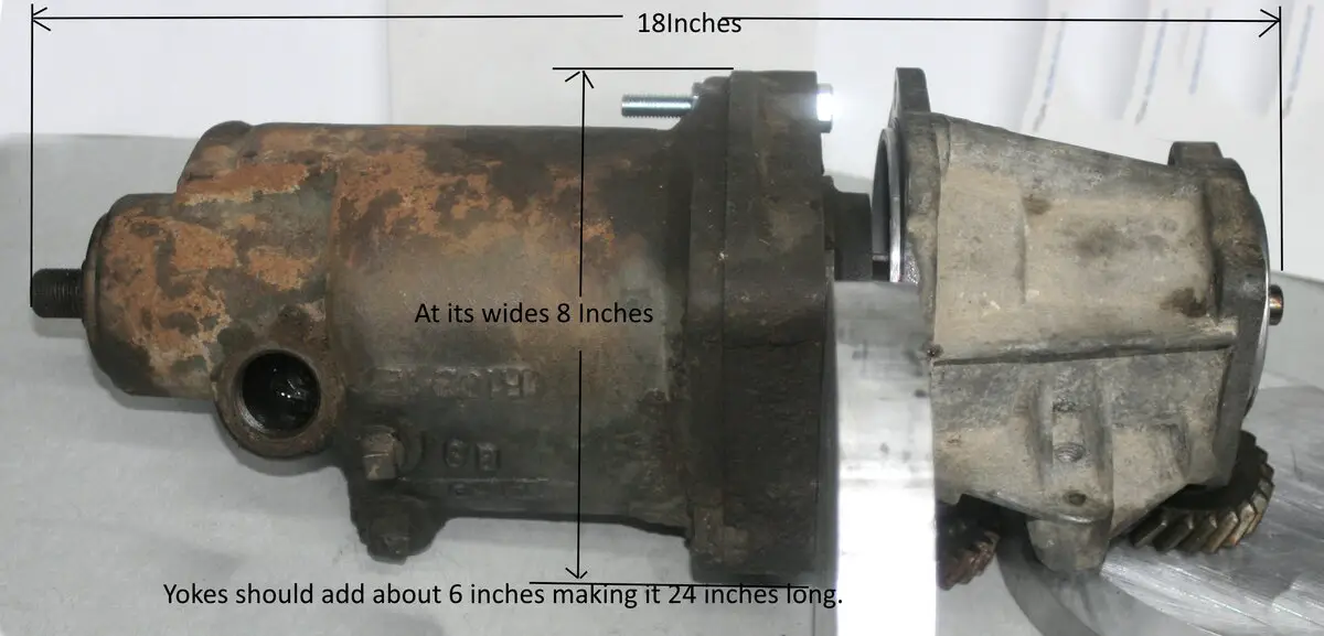

I posted a couple of threads about my plan to add an old Borg Warned R10 overdrive.

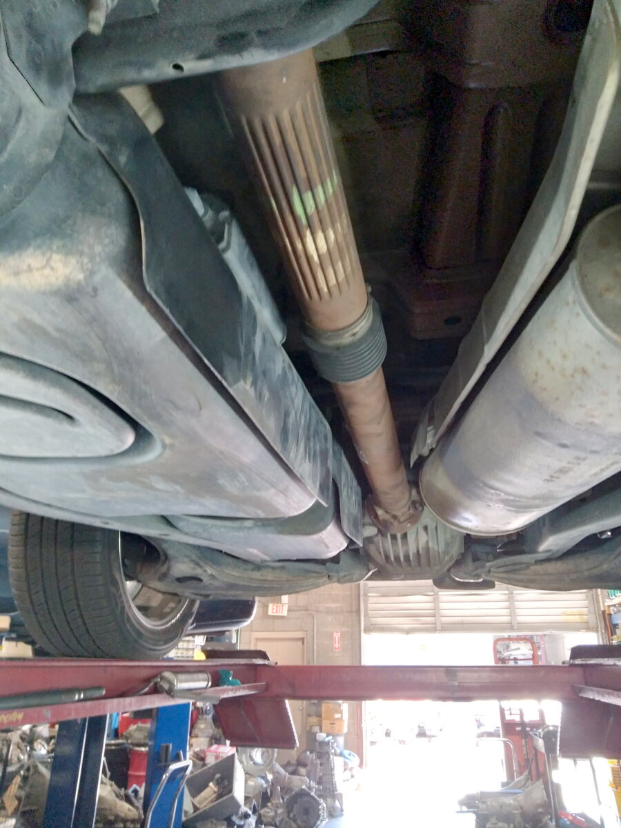

I figured out how to mod the BW Overdrive to have a front yoke, and to run it as straight manual unit thus removing the electric solenoid, making it even smaller.
The biggest problem is they stuck the gas tank inside the rails and between it and the muffler there is very little room under there:
So now I am looking into replacing the BIG muffler with something smaller.
As "U" Joints need to have some deflection, I figure to move the overdrive to the right (or picture) so a smaller muffler will make room for it.
Suggestions are asked for.

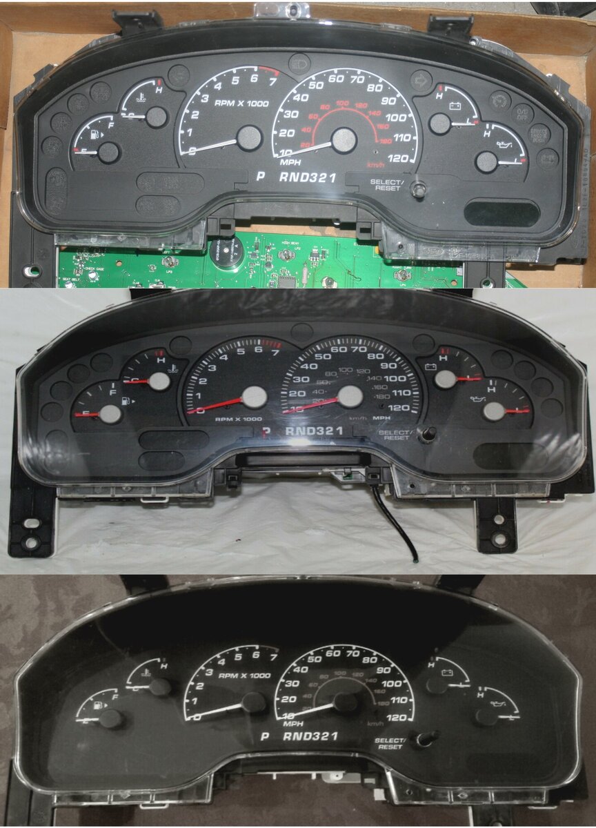

The Cluster: I had a 02 and could see the gauges even in our BRIGHT AZ sun while wearing sunglasses, it was one of the things that seduced me into loving these trucks to only find the 03 cluster was “Improved” and made nearly invisible, SO I am combining a 02 cluster with a 03.
The modified one is the top one. Note the lower two and how brighter the lower one is the the one just above.

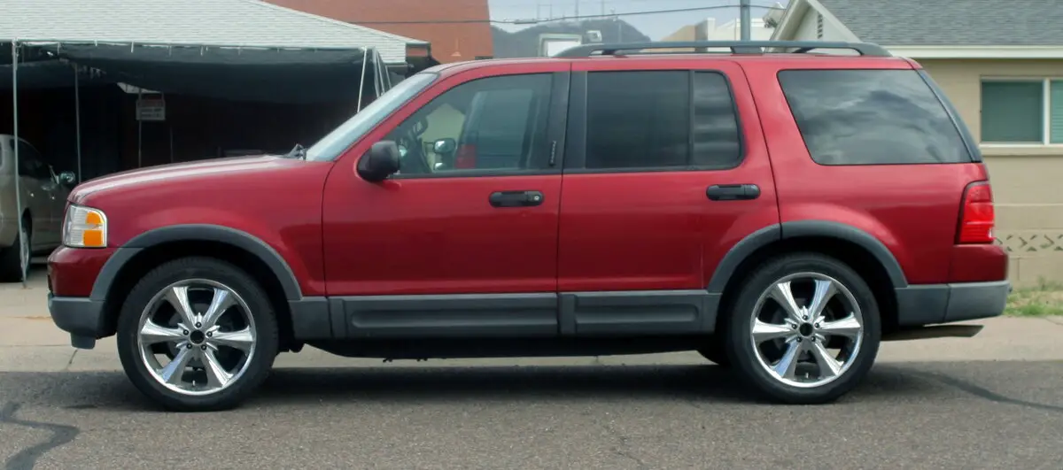

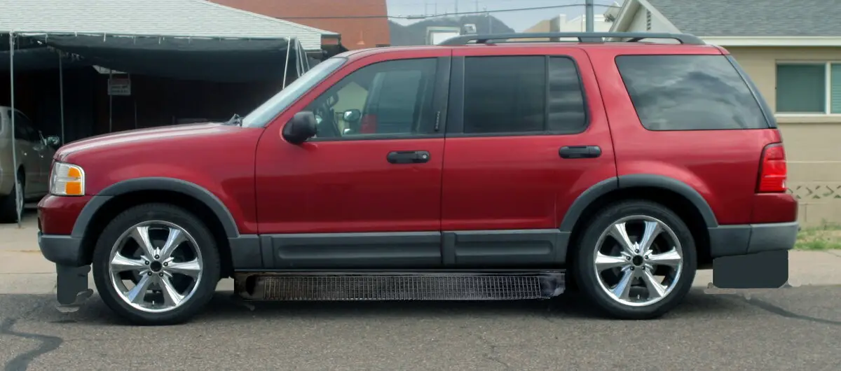

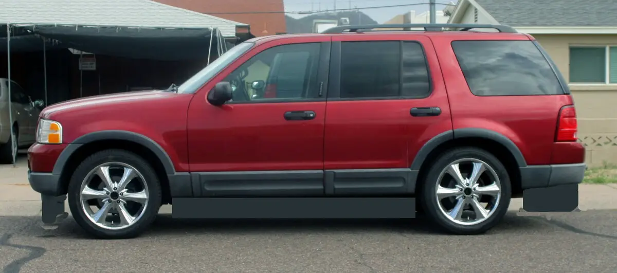

I HATE the Stuck up in the air ass end of these trucks, they look like an old cartoon after being kicked in the ass. Yes I know these are meant as being able go off road, but look under them and the front end and the rear end with its control arms REALLY limit the ground clearance.
So I did two things, I bought Bell Tech’s set of lowering springs (2” front 2.5” rear) and now it looks great, AND I proved these springs will work on a 4WD. That’s done.

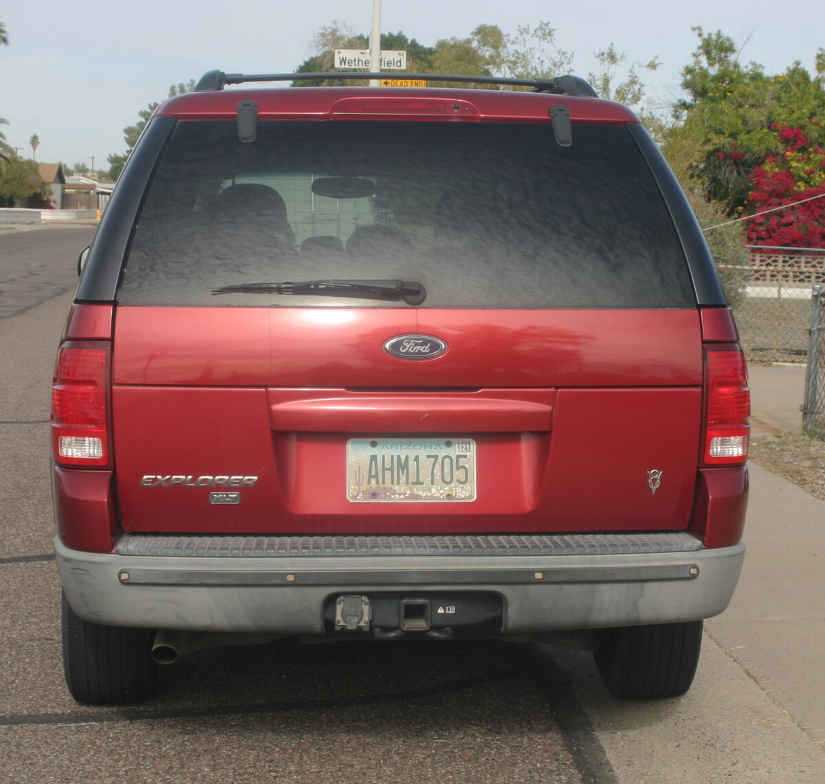

The rear hatch, I read that a 06 hatch fits, gets rid of those crappy plastic panels.

Lastly with her lowered I removed the useless running boards and plan on using them as ground effects siding and adding a lowered air dam up front.

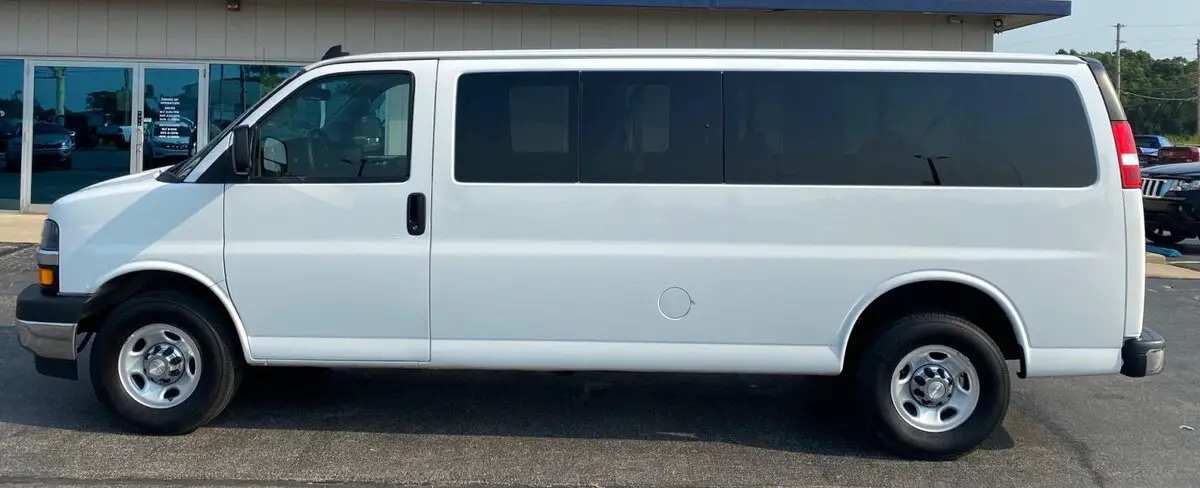

First check this out:
This what I get looking up said van:
This is a bigger heavier taller box that my little Explorer.
And I have other personal reports of the small diesel version of these vans also getting 29/30MPG at 68/70MPH. Of interest is 70MPH as a number reported they had to be doing 68+ MPH to even get them into 8th gear
So as far as the old myth that these big boxes cannot get good MPG as they ARE big boxes is busted.

Those vans are also probably a lot more aerodynamic than you think. The roof is flat with nothing to buffet air, and the rest of the van is fairly rounded.
Funny as that is one of my points.
If the solution to great MPG was simply raising the gearing they’d all just have super tall gears.
It is a fact that decades ago you COULD buy a GM car with super highway gears, like 2.24s and 2.40s but not now. I consider the newer 6 and 8 speed transmission with such gearing but cannot find them but in 40 year old worn out cars. Such would work great, but the lowest gears I can get for a Ford or GM is 2.73.
