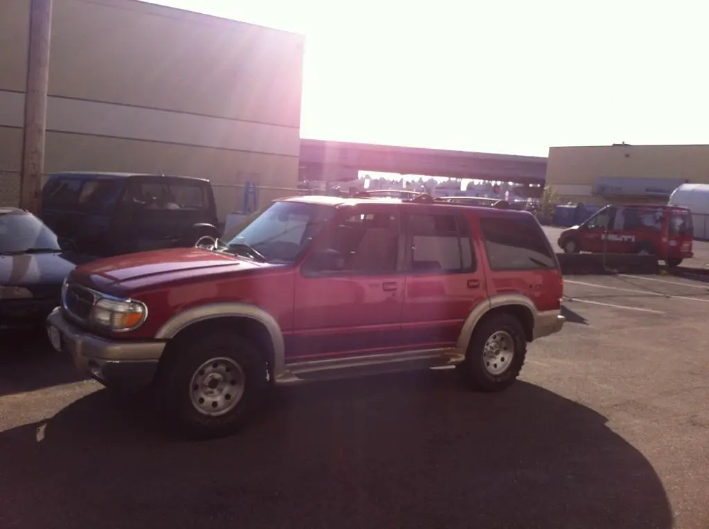

Did a bit of work over the last couple of days.... First off I changed the leaf springs for a ford F65 pack from a 1998 F150. I just did a straight swap, but I may change it. Unloaded the springs are the same length Eye to Eye but along the curve they are longer. The truck rides better than it did before and it gave me 2" of lift and a ton more droop, but I may mix and match the f150 spring with the Explorer spring. But anyways heres a before and after and some during shots :P

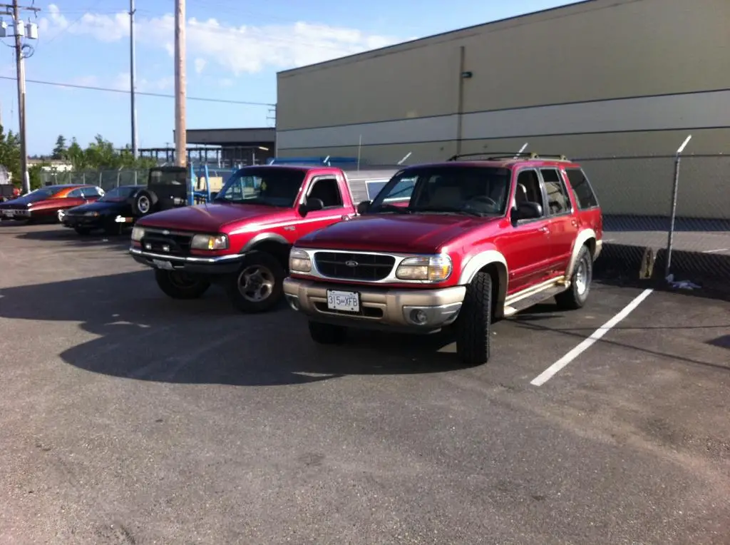

A comparasin, the 2 F150 leafs in the back and the Explorer leaf in the front

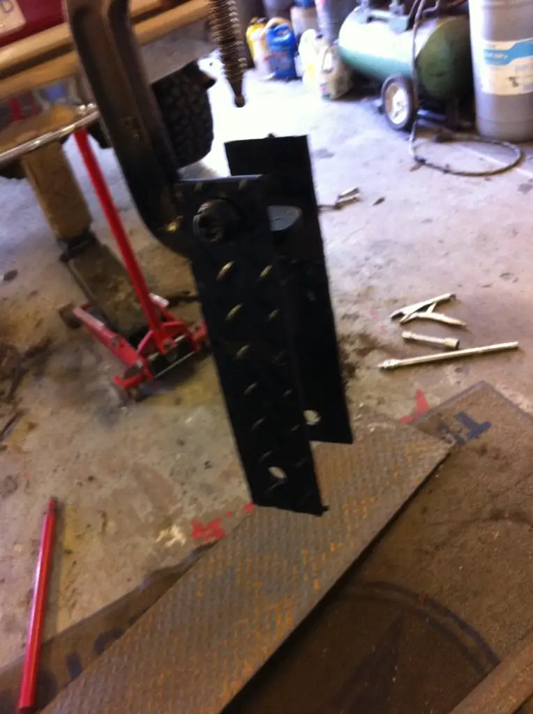

Also I did a mock up of the front winch bumper with the Warn Bellevue series winch. I need more tubing, and at the moment I have no were to weld, we just moved out of our shop :P

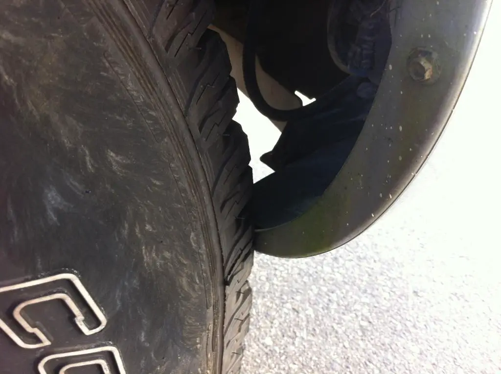

So, I have a question for you guys... With the new leafs and a torsion twist I have 2" of lift total, on 32s. Theres plenty of room for 32s (Minor bumper trimming), I think I could get 33s on as it sits. my question is, if i did a 3" body lift, would I clear 35s? Or should I stick with 33s?
I have 33" mud terrains on my 96 sport with a TT, aal and shackles, minor trim in the front, none in the rear and no rub, if that helps you. wheels are alcoa 15x8 3.5" BS
