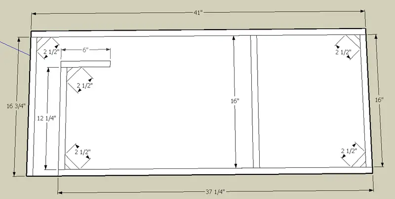

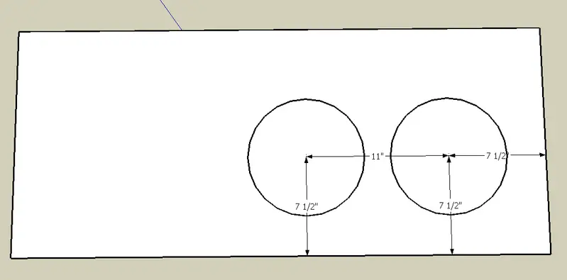

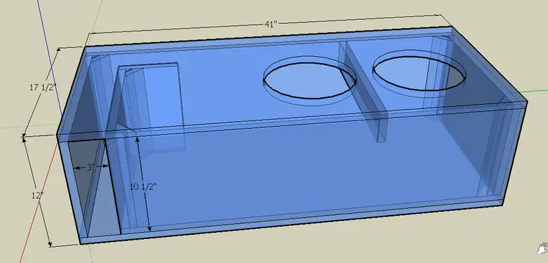

Here you go...3 cu ft at 33hz
Baffle - 41" x 17.5"
Bottom - 41" x 17.5"
Back - 41" x 10.5"
Right side - 16" x 10.5"
Front - 37.25" x 10.5"
Left side - 16.75" x 10.5"
Port I - 12.25" x 10.5"
Port II - 6" x 10.5"
Baffle brace is 16" x 3"
looks good!
does it make a difference in the exploders if the subs face up instead of towards the hatch? I know the 10s will fit on the front and still be under the 12" requirement. Not trying to be combative here, just trying to further my knowledge.
Again, thanks for the words of wisdom, tomorrow should be fun and I hope to have some lovely pics to throw out later tomorrow!
also, should I use a router to knock off the 90* angles on the port? round them over or something, or does it matter at all?
Generally Explorers are louder sub up port back. Either way will sound good though. Some vehicles are louder with the sub and port on axis while others are louder with the sub and port off axis
If you do have a router than rounding the corners will help with turbulence.
