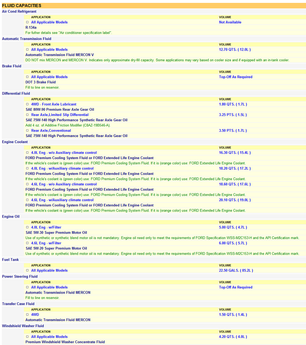

Here are the fluid capacities for future reference. I'm guessing some moron at a parts store told him the V8's capacity?
yes that was the oil alright 6 quart box. Should been 5 quarts in the V6 4.0L
