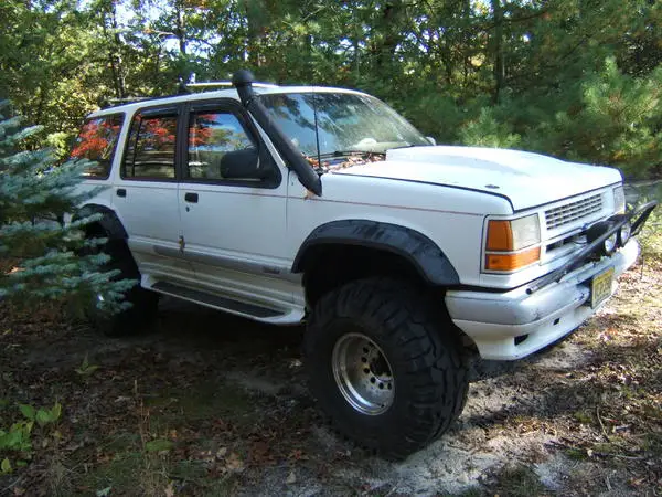

On your two door they might...I believe the rear door would interfere with the flair on a four door. Part of my factory flair opens with the door.
No.
These are GenII ranger flares. You can see I had to cut the bottom off because the bodies are completely different from the molding down. The tops fit ok, not great. The factory upper wheel lip is similar, but different enough that I had to heat and reshape the flare.
