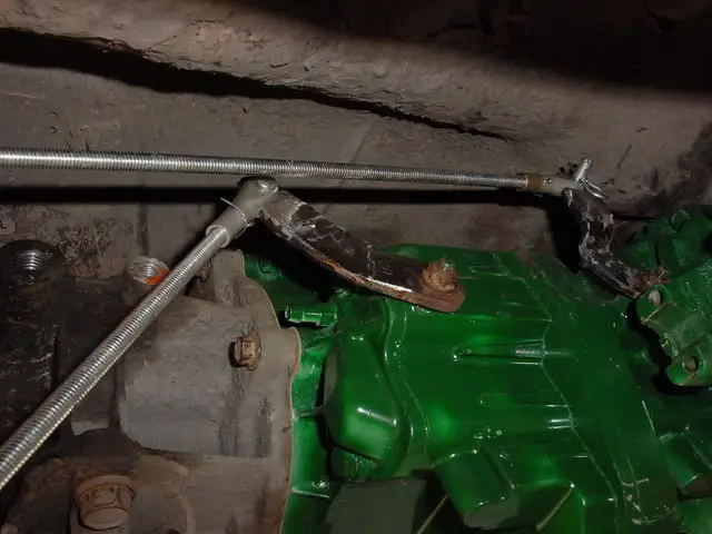

Okay, I'm ordering my doubler kit for you Bronco II next week & I'm planning on running a manual shifted 1350 & a manual shifted 1354 t-case. I wanted to see what you guys that have doubled up are using for manual shifters, I want to see some pics. I seen one guy use a S-10 front axle actuator ( vacuum ) to shift the front t-case, but I'd rather go cable or linkage.

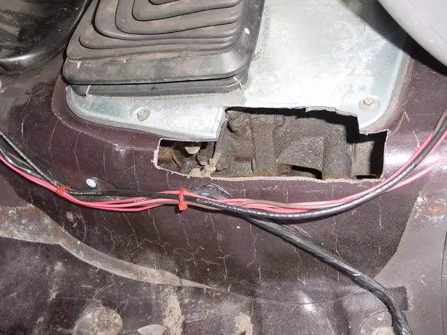

Make it....
Going to keep the flat stock all the way up.
Thinking about an inner tube to seal off the hole.

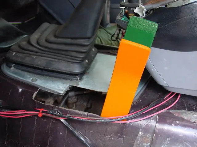

Done.
2wd.
Low
Double low
Shouldn't bug me too much.

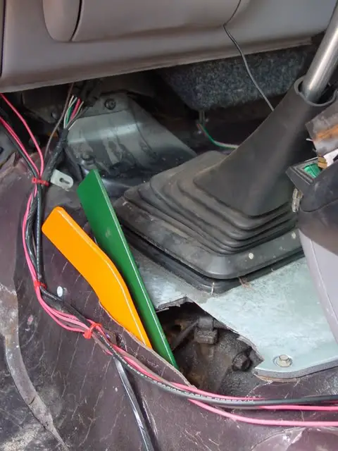

your shifter and t case is very colorful.
i like the side by side shifter arrangement. it makes me wonder if you couldn't use your stock shift linkage and sandwich another shifter made from 1/4 inch flat stock with part of a factory shift lever welded on to give a factory look. you could find a boot for it pretty easy.

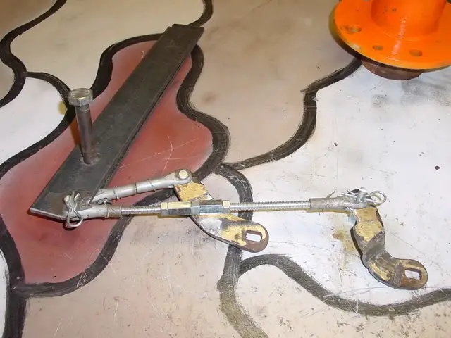

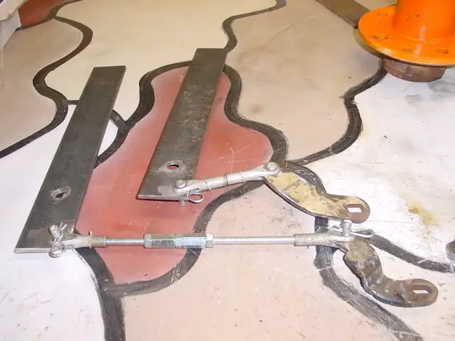

Mine:
(click for bigger)
I wanted to keep it (somewhat) stock-looking.
Stock shifter works like stock, the doubler is push down/pull up.
