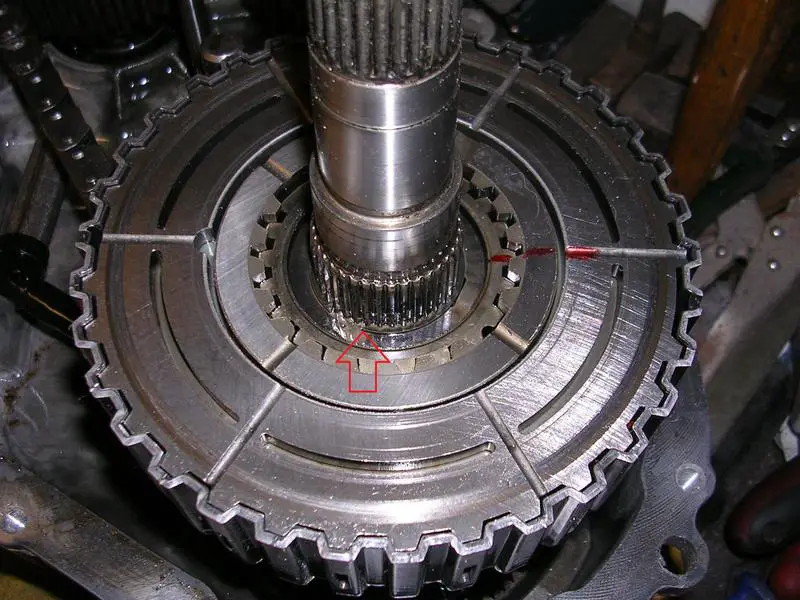

This is a picture from the disassembling, maybe someone could see, if the clutch pack is wrong? Maybe the previous owner "build some mistakes" too.
I will reopen the housing, hope i could identify what causes the tight rotating of the main shaft.

I am a curious guy, so i have to find the fault -> and i found it.
Thank God, it wasn't my mistake!!! Yes!!!
The company who fixed the bearing seat, put 3 shims (0.02inch) under the bearing.
I removed these shims, put the casehalfs together with 8 bolts and tighten the nut.
What should i say, everything runs fine!!!
Some pictures of the clutch pack (you could not put the discs together in a wrong way, cause there are notches).
