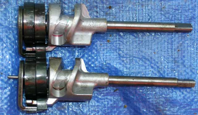

Aligning the shift rail/rod - break the tiny pin on one end during removal or installation and you'll need a new one.
Broken one at the top:
