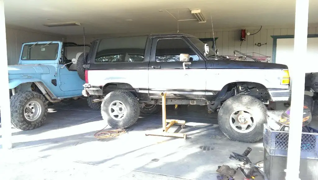

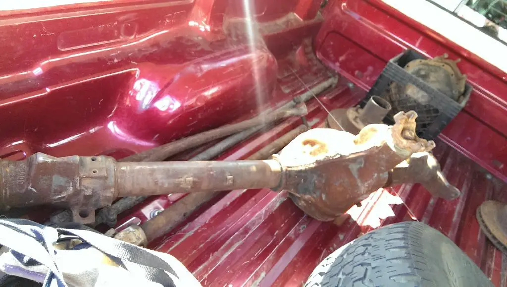

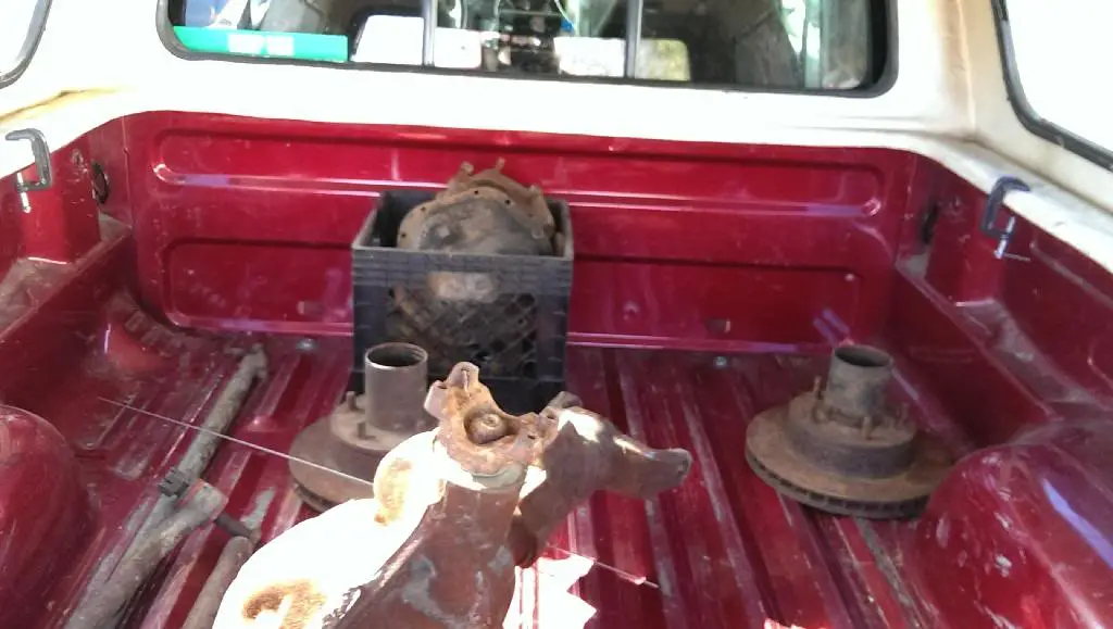

Well, ive gone n' done it. Recently took a road trip up to Northern California to pick up an engine for a buddies FJ40. Well i made the mistake of a looking on craigslist a couple days before the trip, i found what i wanted. After haggling with the guy for a couple of days and him threatining to sell it from underneath me, I called his bluff and came home with this bad boy for 75 bucks and a few fine norther cal beers.

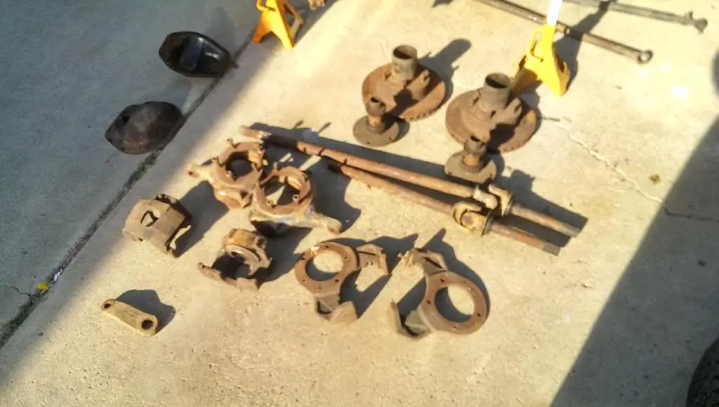

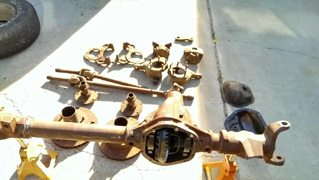

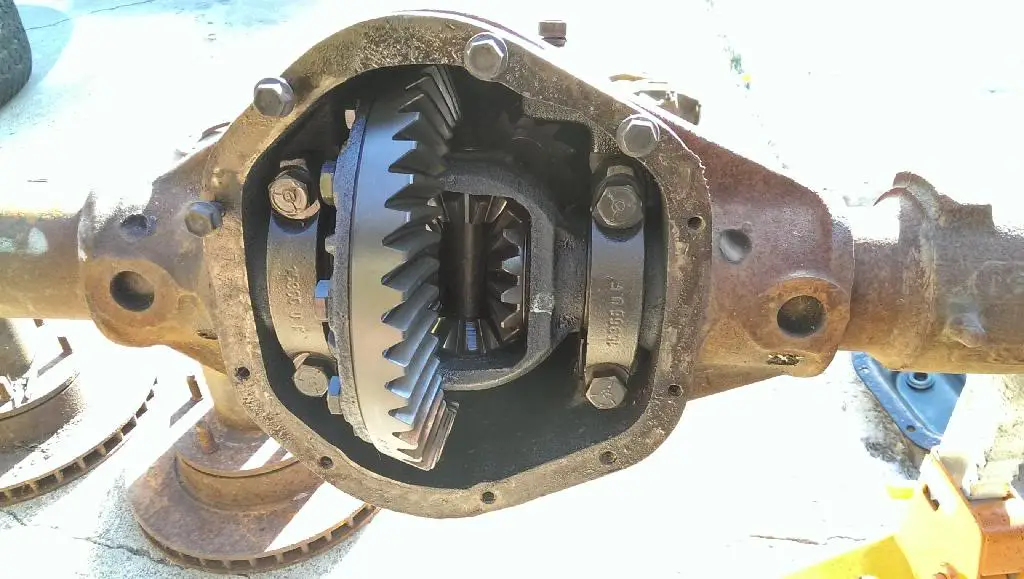

All the guy seemed to think it was, was a early f150 dana 44. nothing else. after inspection when i got it home and looking at the casting number and casting in general, i found out that its a 1978 ford f150 dana 44 High Pinion (I didnt think it was a high pinion when i picked it up) With disc brakes, axles, snouts, disks, panhardbar, deadlink steering shaft and pitman arm with 5 on 5.5 lugs which should compliment my new wheels. Super stoked, time to get rid of the ibeam and upgrade to older equipment.

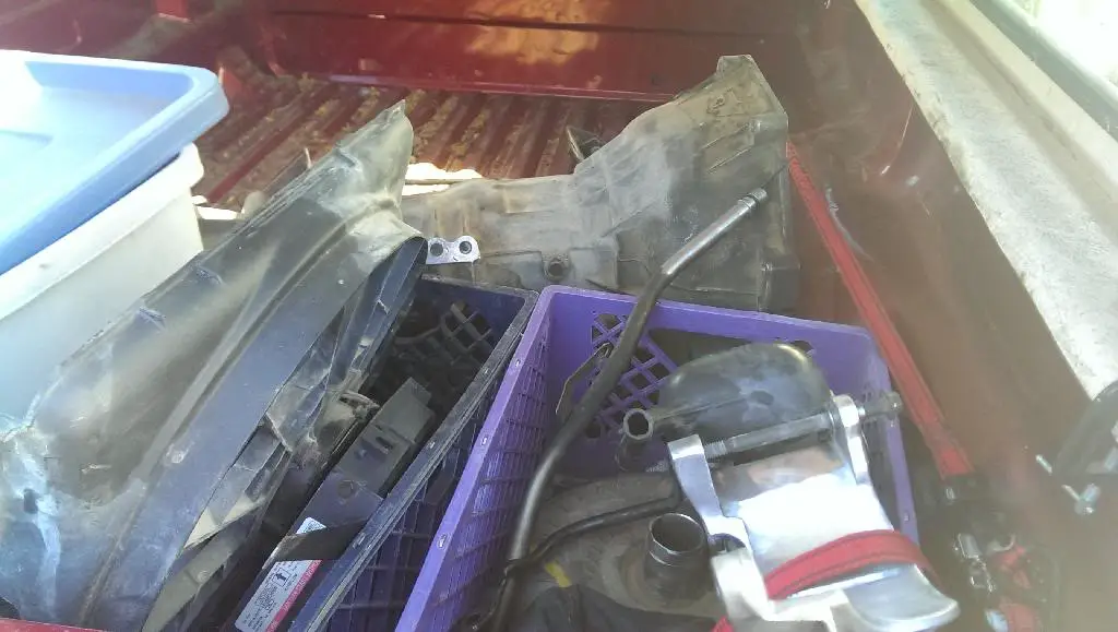

Making some progress! Went to King of the Hammers last weekend, pretty fun time.. Better yet, I met up and grabbed my transmission.

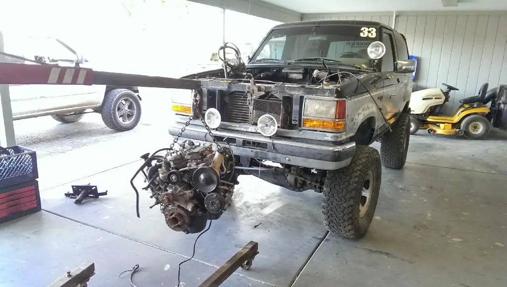

Holy smokes there is alot of drive train in this bad boy. The 302 went it pretty nicely, same with the aod. The np208 barely fit between the frame rails. With the engine in, it completes one main question.. will all this fit into the cute little package. When that was answered, it opened up about 50 new questions. exhaust, engine height, drive shafts, and clearance between the engine and radiator.
Anyways, here are some progress prictures. The engine mounts are just temporary at this point to figure out where I want to place the engine for permanent mounting. hit me with your guys's thoughts!

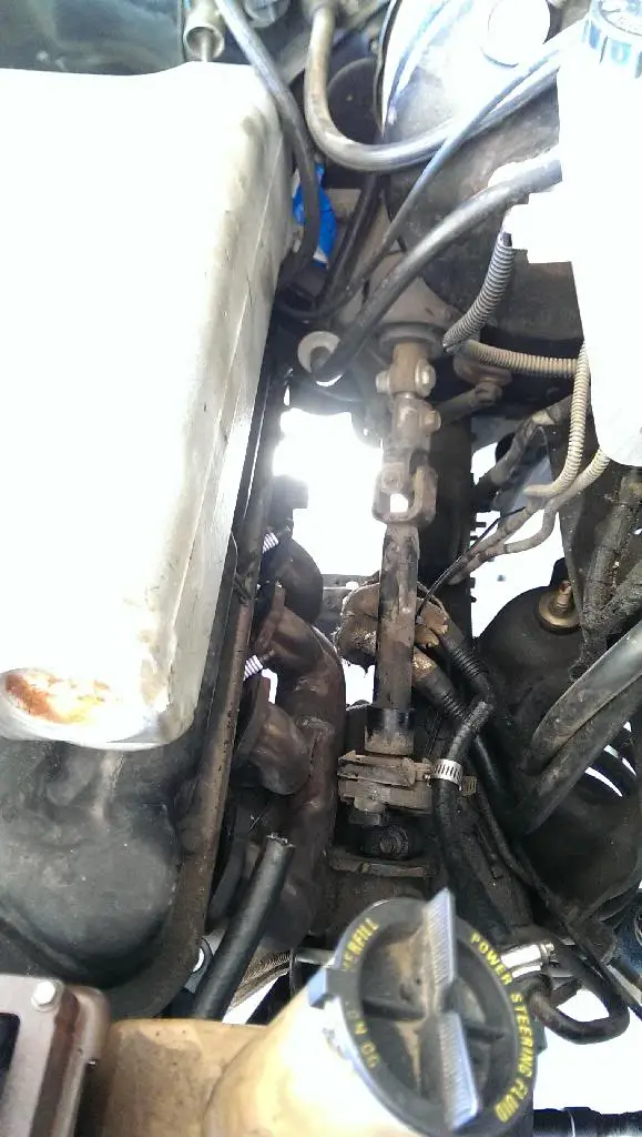

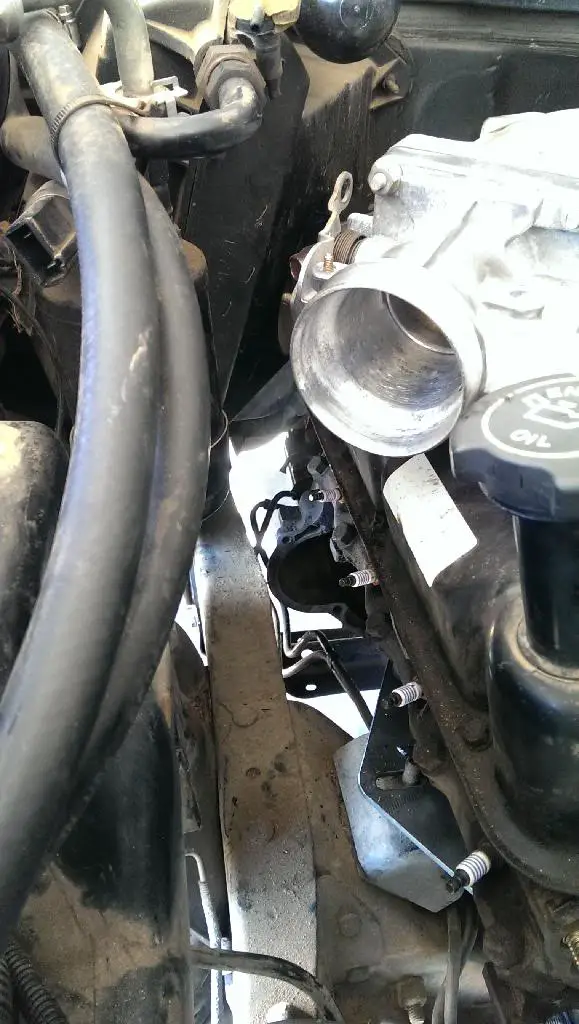

This is what im working with as far as room for the exhaust. Im thinking right now, ill use cast manifolds then down the road pick up some conversion specific headers.
As you can see, im about half an inch off the radiator. that is way too close for comfort.

For those of you with an AOD and 4x4, could i ask for some exhaust pictures, primarily on the driver side? Im looking to see how much room i have for the drive shaft and driver side header collector. id like to try and use the shelby Tri-y headers with modifications of course.

If you are still looking for headers, have you looked at L&L?
Of the 4 sets I tried in my Ranger, the L&L ones fit with the least amount of extra cutting. I only had to slightly modify the firewall (but I have my engine sitting a little high.)
However, the driver's side would not work with the plate style engine mount. I had to get a set of their mounts.
