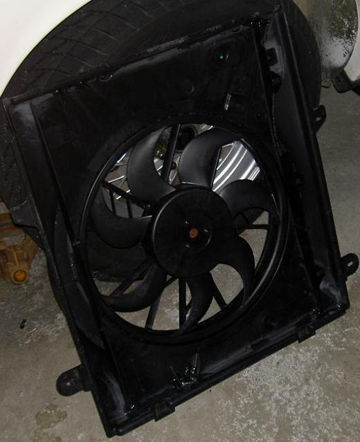

Ok, so I did an e-fan on my '93 Ranger. I used a Volvo fan. It was, I think, out of a V70/V90 or something. It pulls a ton of air. Unfortunately, it also pulls a ton of amps. Too much for the the alternator to keep up with while sitting in traffic at idle. The fan is a single speed fan, in that there is only a single power wire, and a single ground wire going into the motor.
My truck doesn't currently have a/c, but I just bought a parts truck with all the parts I need. Typically, when a/c is turned on, it triggers a relay to power the e-fan, on vehicles factory equipped, in order to ensure airflow over the condenser. However, I don't think I need the full speed this fan is capable of, for that purpose. I also don't think the electrical/charging system could handle it running all the time I would want the a/c on. I know that there are expensive fan controllers capable of regulating speed via PWM, but I don't want to spend a bunch of money on one.
The question is, can I safely run the e-fan at a slower speed, by reducing the supply voltage too it? I'm thinking the A/C clutch wire would trigger a relay supplying a secondary power supply to the fan, with a voltage reducer inline. Then, when the regular temp-based controller turns on, it can just send normal full voltage to the fan.

It appears that the fan currently draws about 40amps.

That being said, I have a Volvo fan in my 99 Explorer, SOHC, and it turned on very slowly every time, with little noise. It never ran fast at all, the radiator cools very well. I believe the Volvo fan is reliable, but I didn't know at full power it would pull that kind of juice.
Good luck with your system, but do concentrate on reliability. The fan must not ever fail to run.

My Volvo turbo wagon has a relay controlled two speed electric fan but there are two windings (3 wires) for the different speeds. As I recall a D.C. motor can be speed controlled by applied voltage but the method is not very efficient when using a resistor to drop the battery voltage. If you measure the resistance of the winding (the two wires) and add a resistor of the same value in series you will halve the voltage to the fan and approximately halve the current flow (i.e. 40 amps to 20 amps). However, the resistor will have to dissipate the same power as the motor consumes. Power = voltage * current or 13.6 * 20 = 272 watts. Pulse width modulation (turning the total voltage on and off) is much more efficient.

Yes... to some extent. DC fans have kinda threshold, a minimal starting voltage - come any lower, and it wouldn't start spinning at all. Can't say for auto fans, but computer 12 volts DC fans typically refuse to start if the voltage is below 6-7 volts - at best.
Useful article: http://en.wikipedia.org/wiki/Fan_control
>B.) Will this harm the fan motor?
It might, if the voltage goes below minimal starting voltage - the fan will try to start spinning, failed and probably overheated.
>D.) Do I need to worry about or protect against "backfeeding" full 12-14v, from the temp controlled circuit, into the reduced voltage circuit, when the full voltage side activates?
Er... ahem. I would put a diode in. Where - depends on the actual scheme.
>E.) What is the approximate relationship between voltage reduction and fan speed reduction, as well as current draw reduction?
It strongly depends on the fan itself, all I can say it's highly non-linear. Something like "15% voltage drop will reduce fan speed in half".
Wow. That's a lot of amps for a cooling fan. If you plan to reduce voltage with a resistor, you will be wasting a lot of energy and generating a lot of excess heat by it. OEM controllers use PWM scheme for a reason - and I would say, for a very, very good reason.
