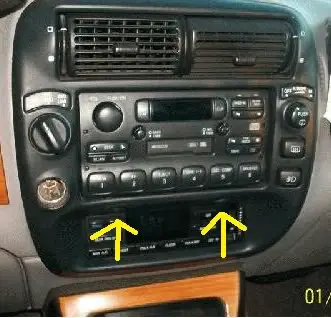

I didnt use a removal tool or coat hangers to get mine out. I took the whole cover off by unscrewing the bolts above the AC, disconected the foglight switch and the others and used my fingers to compress the sides and pushed it out

Sadly coat hangers didn't work. I had to take the bezel out. I think that's what you call it and just remove it from the clips or w/e you call it by pushing.. Was easy in my opinion. Thank you

Autozone sells the radio tools for like 4 bucks. Its definitely worth the money. Other wise take out the bolts above the heater controls as mentioned above. Heres a picture and it makes it way easier to work on.
