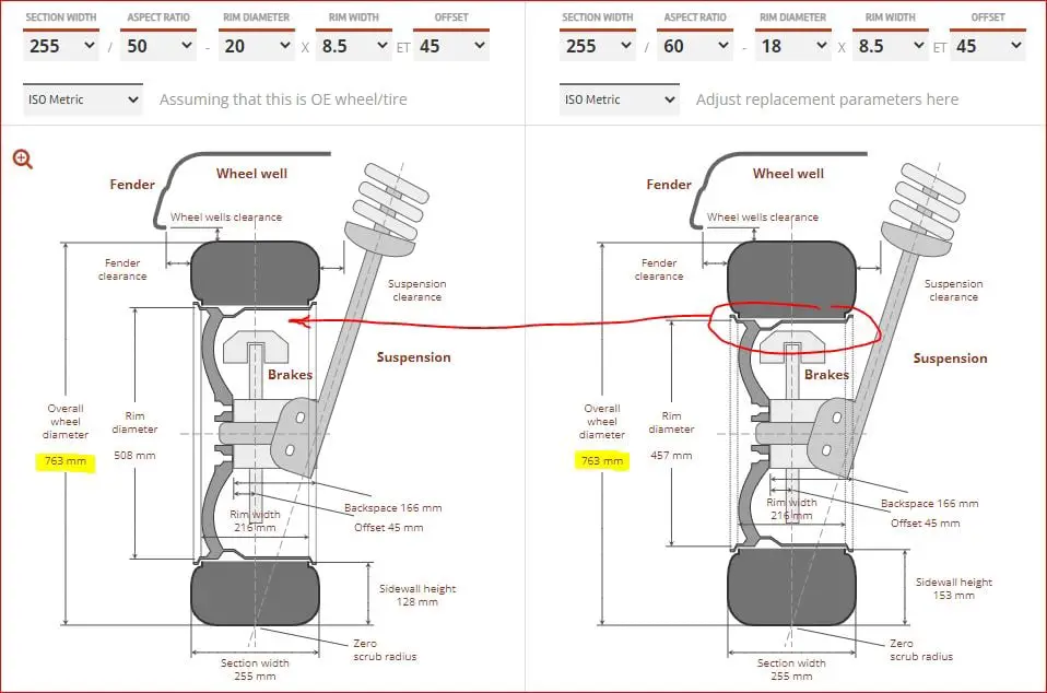

My Explorer came with 20" wheels, I do not like them. not enough rubber. Can I use 18" wheels on my 2017 explorer limited.
Yes, as long as you use a "taller" tire, to be within 3% of overall diameter.
EX: 255/50-20 vs 255/60-18
In fact, I use 20" wheels/tires summertime, and 18" Blizzaks in winter.
18" is as small as you can go. 17" worked on the 2011 to early 2013 models. The brakes were upgraded to heavy duty during the 2013 production cycle. This has been asked before but unfortunately the 'Search' feature still requires some work since the site outage was restored.

VERIFY brake caliper clearance (I do not know), but tires are okay.

If you have 255/55R20 tires now then a 255/65R18 would be an exact match. 255/55 R20 vs 255/65 R18 Tire Size Comparison Table with Graphic Visualization (inch difference)
