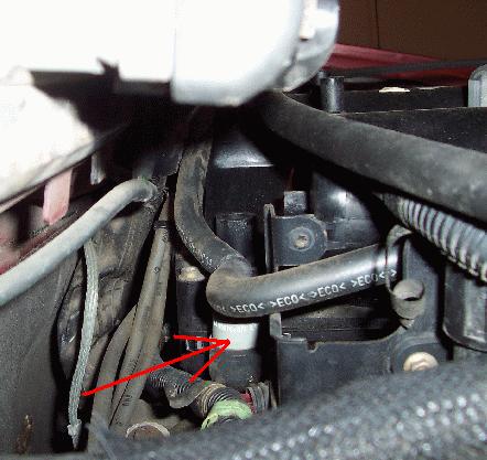

Its on the back of the motor by the firewall, and it is pretty miserable to get to.
changing that sucker is a real PITA. especially once the hose it plugs into is old a stiff.
PCV Valve photo
I accessed mine from the passenger side but it wasn't easy and I broke the flimsy support that attached it to the upper intake manifold.
I had bought the materials to do SR2K's PVC mod and somehow miraculously found a way to get the old one out and a new one in without the mod. Lots of naughty words and skinned knuckles, tho. It's a real PITA. I don't anticipate changing it again. Ever.

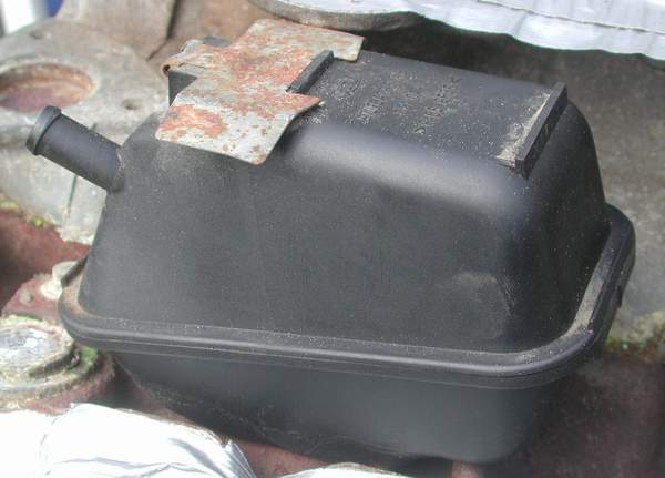

breather assembly
Is this what you mean by breather assembly?
The crankcase ventilation flow is shown below.
MAF sensor > passenger valve cover port > crankcase > breather > PCV valve > upper intake manifold
Disconnecting the hose from the breather allowed unrestricted, unmetered air to enter the intake manifold causing a too lean condition for the engine to idle. If you have a hand vacuum pump you could connect it to the hose end disconnected from the breather to test for reverse flow in the PCV valve. Or, I think if you left the hose to the breather disconnected, disconnected both hoses from the PCV valve at the upper intake manifold, plugged one of the hoses and blew into the other one that would test the PCV check valve. There should be restricted flow in that direction. I've never tried either method and could be wrong.
No, it was not that....it was the upper manifold.
