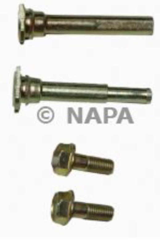

Hello everyone I have a 2003 Explorer that I have owned since it was new. Recently I took a stab at replacing the front drivers side hub bearing assembly. The most that I personally have done before with this vehicle was changing pads and rotors. Things didn't go so well. I got down to the bearing but could not remove the screws on the backside eventually I stopped because my socket had slipped off of the bolt twice and I was worried about rounding the head of the bolt. Putting the caliper back on one of the caliper bolts just spins inside of the caliper pin. I now can't get that bolt back out. Any tips on getting the spinning caliper bolt out and also removing the bolts from the front bearing would be greatly appreciated. Thanks
