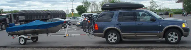

After some deliberations, I decided to go with the Thule 604. Bought it at a local Scheels for 429.00 Box looks great on the truck. Had to head back to ND so we took it as the maiden trip. The truck did really well with it on. Had to close the sunroof glare shade because wind noise was a bit louder. But it was to be expected. We drove at 82 mph all the way. With wind gusts up to 50 mph and had no problems. On the way there we got about 15.3 mpg average and on the way back with out all the wind we got about 16.9 average. 17.4 is our regular average before so not too much off. I will get some pics up of how it looks and how it mounts on the bars if you would like.

i got one no problems. . Its a thule paid about $200 for it.
