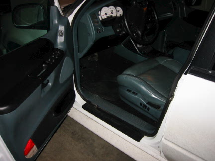

i have recarpeted my green/blue leather interiored explorer with a black carpet kit from headlinerkit.com (or something close to that) the kit was 150 dollars and the install took me roughly 6 hours. i love the end results.
keep in mind that is just for recarpeting the passenger area, you'll have to go to home depot or menards and buy some matching carpet for the cargo area too for about 30 dollars more.
once again, its easy and i love my results, you should do it too

Definitely replace it. Its pretty easy to gut the inside of an X. If you search around on here there is a thread or two about replacing the carpet, using different colors, and good places to get them.
I think the stock color would be the best replacement to get. However, black might look alright. But I wouldn't throw any grays into the mix. I think Expo5.0 has black carpet in his ride now. Search through the gallery for his ride if you wanna. :p
