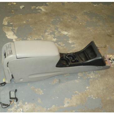

The ticking/clicking noise was really getting to me so I opened up the center console. Attached to the blower motor housing is a white box. The noise was coming from this box, part #F57H 19E616 CA (blender motor). To stop the noise you can just unplug the blend door motor and the noise will go away. Make sure the blend door is in the open position when you do or you won't get any air flow.
NOTE: The 97's had this blend door and blend door motor in the center console but a 99 that I had did not.

UPDATE February 2024: I did it. I replaced the blend door motor in the center console with another one I picked up for about $30. It took 3 hours in total. 1 hour and 30 minutes to get one stubborn screw in the tightest of places.
I followed this aged guide on how to remove the center console.
I then flipped it around and found the white box that was the blend door actuator. I followed this guide on how to get the white box out without removing the plastic.
It was very challenging to get that third screw off. I used an airbag pump to bulge the center console plastic to its near-breaking point so I could wedge my hand in there and painstakingly, millimeter by millimeter, unscrew the third gold 5/16" screw out with a hand wrench. None of my socket wrenches were thin enough to get back there.
All is well. Good luck to anyone out there with the same issue!
