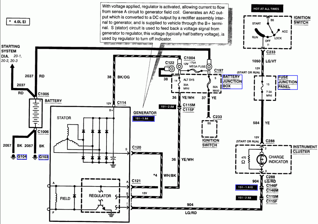

checked schematic and best I can figur after chkg is
BLK/OG wire good, ran new wire fm B+ to dist box and reads 12.6v
30 amp mini good
50 amp maxi good
175amp mega ??? shows continuity but (can I jump this with a jumper?)
anything I missed?
I'll see if I can send schematic
Here you go.
It's not that uncommon for the connection at the battery terminal to be bad. But as you can see by the diagram there is only 3 things in line on the positive side. Try this, take your jumper cable from the B+ on the alt to the side of the mega fusae that hase the blk/or wire on it. If not charging, move it to the other side of the fuse. If its charging the fuse is bad, if not move the cable to the positive battery term again to double check. If charging the wire from the battery to the mega fuse is bad.
That 30a mini gets its 12v from the battery through the same feed as the B+ of the alt. If that mega fuse isn't getting the correct voltage neither the B+ or the field will do its part in charging.

I jumped mega fuse 175a and bingo I have 14.4v at battery charging and chg battery light is out on dash.
YOU GUYS ARE AWESOME!!!!! THANK YOU SOOOOOO MUCH
Congratulations. Good job, awesome that you figured it out. I would put money on the fact that at some point during the starter work or alt change outs that positive wire touched ground and blew that fuse. The sweet smell of success. Now just pick up a new fuse and you're home free.
