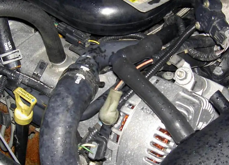

Run your new wire along the same path as the old one. You can remove the old one, but it's fine to simply attach the new one on top of the existing connections. I did that with my 99 truck in 2006, since I have an on board 30amp air compressor. I think I just added an 8 gauge wire, the bigger wires will take special terminal ends to attach those.

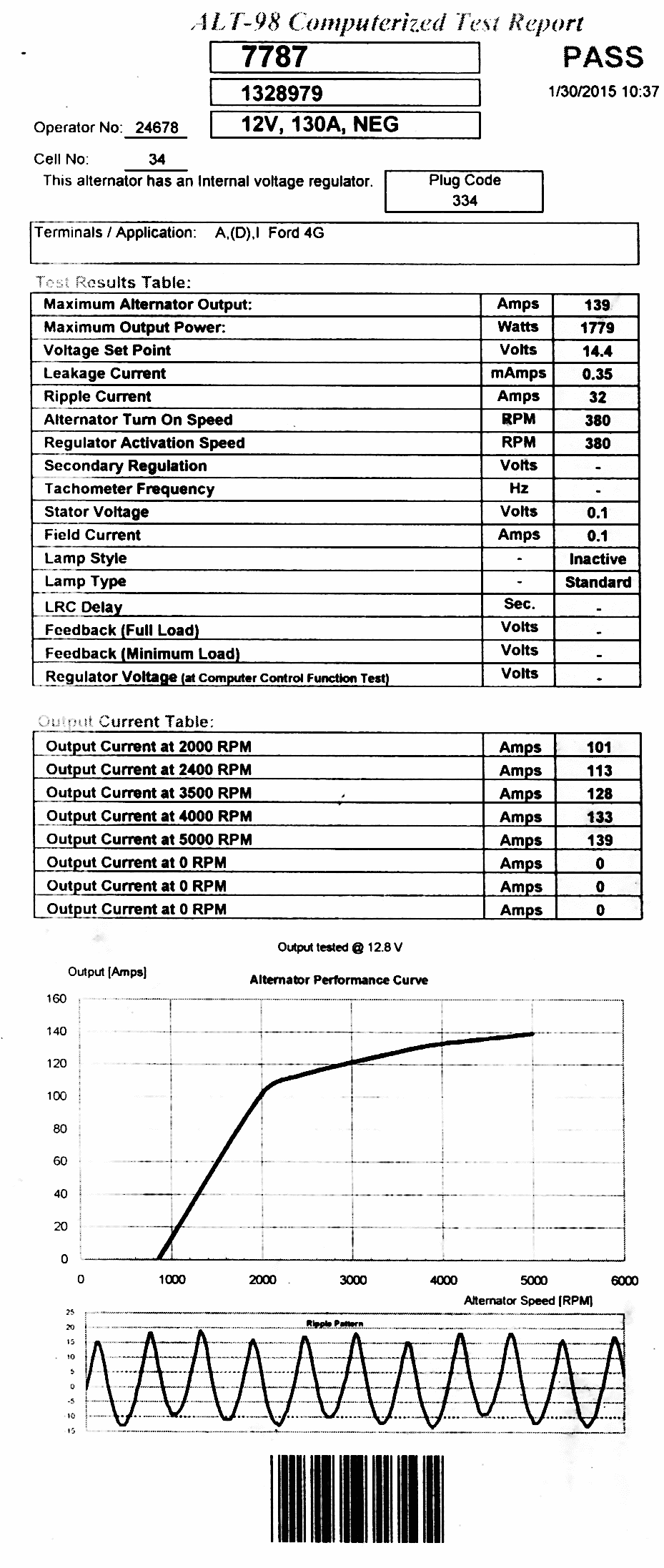

Here is an alternator test report that came with the 130A alternator I put on my '98 SOHC a (couple?) years ago. Note that RPM on it is alternator RPM not engine RPM.
It's just the standard Advance Auto Parts Carquest reman they sell, nothing special.
Advance Auto Parts - Down for Maintenance
