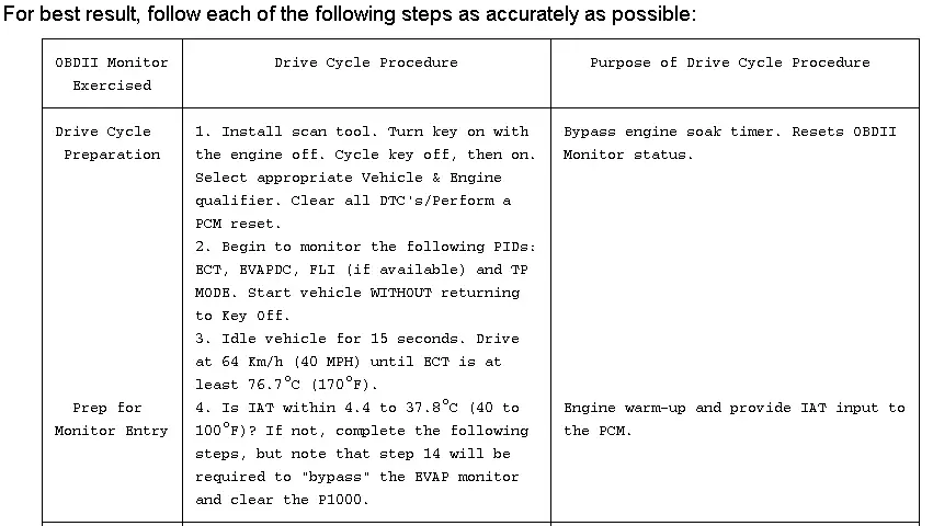

I'll look in my 2000 service manual. I think you can by pass the cold soak and get the computer back on track quickly.
I don't know if this is any help at all. You may just need to drive it a while to see if any codes show up. Anyway this is what was in the Ford book.
Thanks for the feedback I don't think my $40 code reader is going to do anything like that. Like you said i may just need to drive it more. I have only driven 30 miles since changing the battery. Then I disconnected the battery and left the lights on for half an hour today. So I'm back to zero again. How long does it take for the computer to learn all the parameters to run properly?

30 is not enough for the computer to learn. I have cleared codes without repairing the problem and they don't reappear sometimes for 150 to 200 miles.
As for the old battery problem, yes if it had a bad cell or two that was drawing the voltage down, that would cause problems while your driving.
Most engine sensors are variable voltage devices that require a good 12v source. So I guess time will tell, go for a ride but not to far from home.:D
