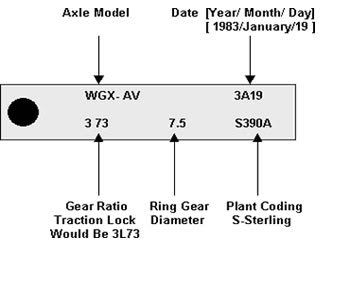

There should be a tag under one of the bolts on your rear end with a code on it that tells you what's inside(in code of course)
just to know a little bit about your truck though, it might be good for you to have a look. yes, opening the rear diff cover is a just fine way to empty the fluid. there's a little bit of a lip, so when you open it, some fluid will remain at the bottom, and so you'll keep a little old goo in there if you don't scoop it out.
about the posi, you probably have a trac-loc, which is a factory limited slip,
but no that's not full time.
here's how to figure out what you have....
