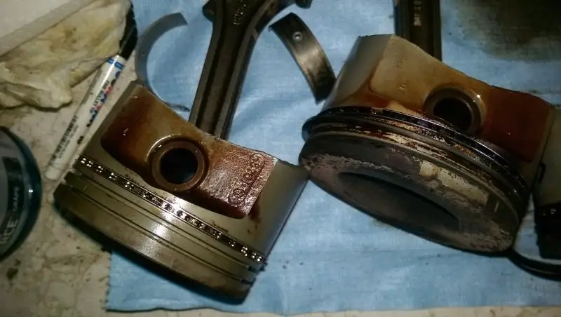

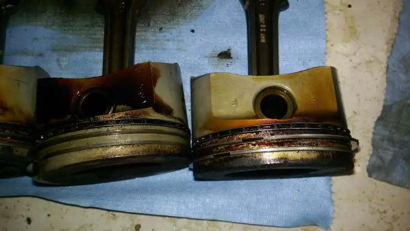

Couple pictures from last night. I got home, was one bolt short on the engine stand, had to run out and grab that. Back home, got it on the stand, got the remaining head pulled off and dropped the oil pan back off. At that point my uncle showed up and I didn't want to be like hold on, let me snap some photos... We just started tearing down and cleaning up. So... Ended up not really getting many photos to show but here's two that kind of show a bit of a smoking gun.
Here's the pistons of the two cylinders I've fouled plugs in.
left one here...
and left one here...
The detail to notice is between the top two rings, the piston itself... See how clean it is? It was obviously pumping fluid past the those rings because if it wasn't it would be more carboned up like the pistons sitting next to each of those. Gut feeling is I was actually getting coolant from the second picture piston and oil from the first. Reason being, the head on the first picture piston was soaked in oil... Duh... Where the top of the block in a small area on the second pictured piston had some witness mark of water getting past the gasket.
