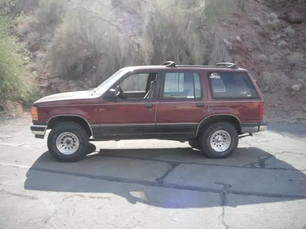

Here's the interesting thing... Reciepts show the reman engine installed at 99K in '08. Guy I bought it from had 5 cars, said this expo was just what he used to take the dogs out duck hunting in and didn't see much use. The overall condition of the expo other then dog hair seemed to validate his story. The odo right now has 45K on it though, so we're talking either 47K miles in 6 years or 147K in 6 years. The story and my gut feeling is it's the 47K mark but the engine screams 147K if not more on it. All the reciepts I have for the work match the vin and stuff though, it was this expo, work done at a ford dealer even. I have paper work for the transmission being done at the same dealer in '07. I bought it 2 years ago now if I remember correctly.
WHen I bought it...

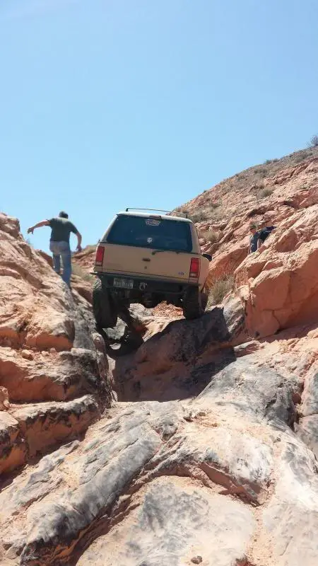

And 8 weeks later... LOL
Yes, same rig... Slightly modified! LOL
Good looking rig :)
