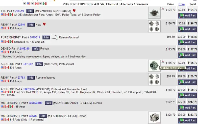

So i'm looking at a price for an alternator...not sure which to good with. New or reman? Brand?

I bought mine at Advance. It's a Driverworks reman 130 amp with a 1 year warranty for $145.00 + $25.00 core. Order online and pick up at the store using the discount code at the top of their webpage and save 15% ($21.75)
It takes about 15 minutes to change it, but I'd definitely make sure it's acting up first by putting a meter on it.
