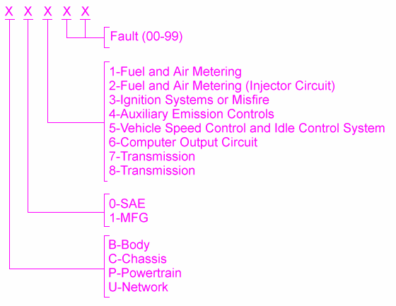

Auto Zone read the code as P01130 & P01131, but he couldn't find out what they meant.
Any ideas?
Thanks!
Heres an idea of the codes.
P0130 O2 Sensor Circuit Malfunction (Bank 1 Sensor 1) and P0131 O2 Sensor Circuit Low Voltage (Bank 1 Sensor 1) thats right from my code readers book looks to me like that had too many numbers
so from the looks of it you need to replace your oxygen sensor

chameleon you have put a 1 in double in your numbers thats why no one found it :P
I just put it exactly as the Auto Zone dude wrote it down.
