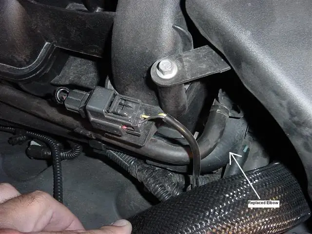

Hi my explorer...an 02 4.0 sohc is now throwing a cel and from what ive been reading ive heard its either an elbow thats sucking in air or the maf...where would I find this fabled elbow thats apparently notorious for causing problems?
Just out of curiosity...is there any way for me to check the gaskets without ripping it apart or no? I am not horribly mechanically inclined and im not confident in taking apart the engine...hoses are one thing but actual unbolting and retorqueing im not sure of at all. Unless it were a cummins...then I could in my sleep lmao
PCV elbow, it's in front of the right side of the intake. Oil accumulate in them and they soften and crack/split on the underside. Motorcraft KCV190 replacement #.
Thank you! I will check that today! I also noticed for some reason one of my hoses doesnt have a clamp on it and seems fluted at the end...now im no genius but im assuming that all hoses are supposed to be clamped where they connect lol
