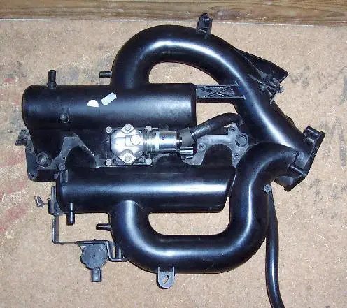

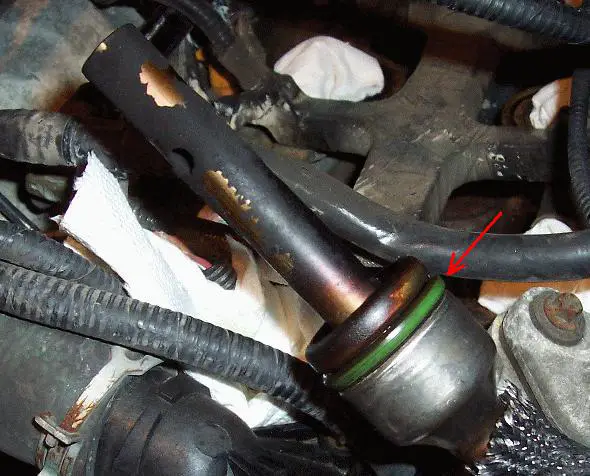

EGR tube O ring?
The O ring that seals the EGR tube where it enters the upper intake manifold also becomes brittle with age. It often breaks when removing/installing the upper intake manifold.
Some members break the flexible elbow just upstream of the IAC valve when removing/installing the upper intake manifold.
Also, check the EGR valve gasket for leaks.
