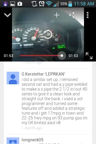

I was looking at exaust setups an came upon a guy claiming to get up to 25mpg in an 04 AWD V8 explorer with an sct tuner and custom exaust. I have 33x10.5 tires and get a calculated average of 15, and if i stay at or under 2k rpms and stay off of the breaks i get 17.
Needles to say id love to get 20 + mpg and was wondering if this may be realistic?
With an 8mpg gain this could pay for its self. Let me know your exerience with similar setups.

He must be running stock tires and no lift. I don't think you're going to get that with just an exhaust and a tune with your setup.
If you have 3.55 gears now, swapping in a set of junkyard 3.73 diff (or diffs if you're 4wd) will help, or you can regear your existing diffs to 4.10.
Manage your expectations and you won't be disappointed. I think 20 MPG for your setup could be attainable but I think you'd have to sink some money into regearing to get there.

Most of his gains are probably from hypeemiling. Or bad math

If you are wanting to get 25mpg, you are in the wrong car. I'm not saying it's not possible since Aldive was able to get 30+ mpg out of his 2nd gen, but it will be a lot of work to make that a consistent figure. A more reasonable number would be 20mpg and I would be tickled if I could get that.
