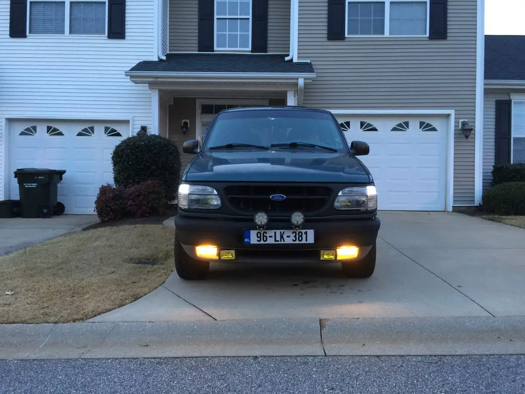

I've always rocked amber foggies.
As a general rule, you should keep all your lighting the same color temperature. It makes it easier to see, when all of your lights are the same color / color temperature.
I've always gone with a modified version of that rule. All my down low & close in lighting is amber, all my long range lighting (including my headlights) is white.
This scheme has always served me pretty well.

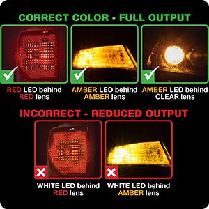

Applies to LED only? Compliments of Sylvania.
