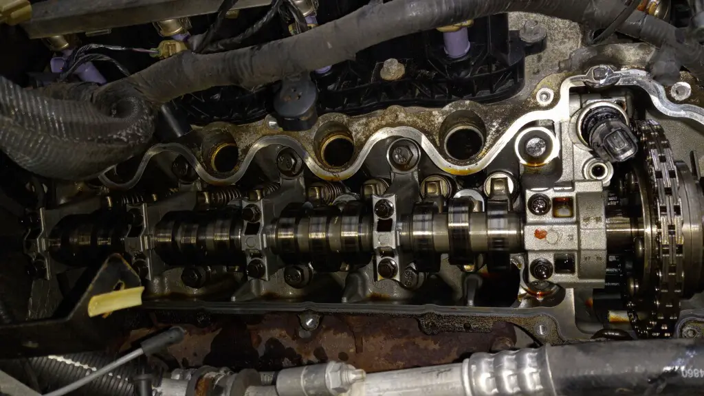

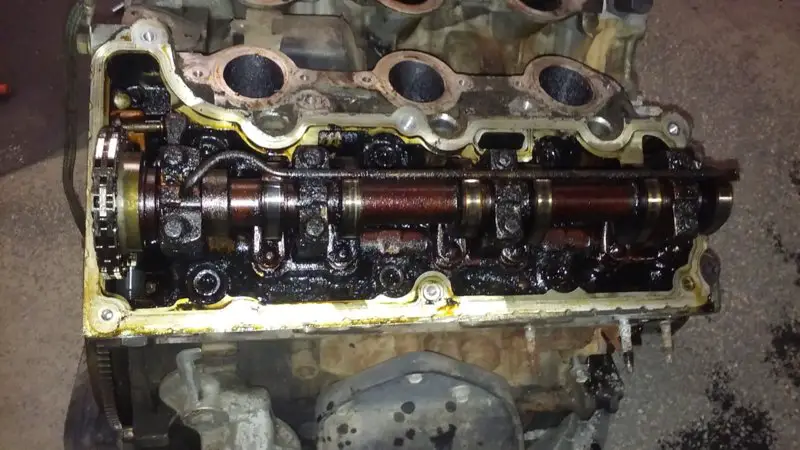

@donalds,My bet is your oil spray bars being Clogged
No oil spraying down on the cams makes for some noise
No matter what you have to remove your valve covers
Thanks! Let's assume (for discussion purposes only) that my oil spray bars are clogged. That raises two questions:
1. Without taking anything apart, how can I unclog the oil spray bars?
2. If I remove the valve covers, then how do I unclog the oil spray bars?
Any insights would be greatly appreciated.
