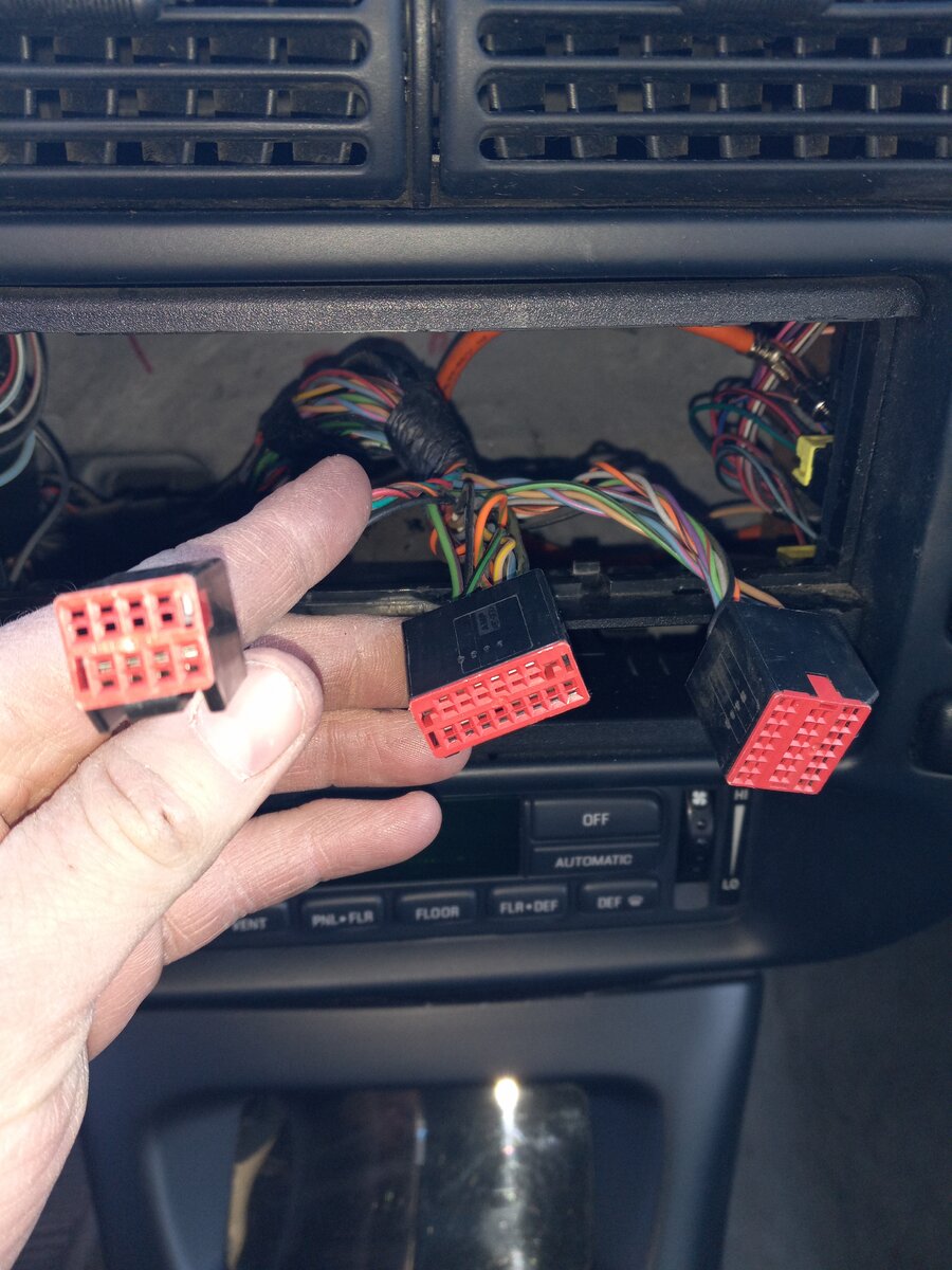

Furthermore, is the wiring (as seen in photo below) the stock harness or is this an aftermarket job?
Thoughts? Thanks in advance.

not sure baout fuses etc, but the harnesses look stock to me! at least my radio ahrnesses look the same color scheme, taping, etc etc

Wiring looks stock to me, why would it be aftermarket? Exporer EB's tended to come with the EATC feature so would already have the right wiring harness.
