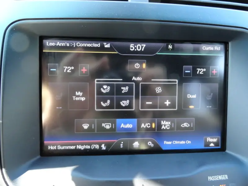

Here's my climate screen on MFT that I've owned for 1 week.
Yes, the "auto" button puts on the air when needed and the heat when needed - depending on the temp set. (side note: if I push and hold "my temp" - it will set the memory with it. Haven't fully explored that one yet.)
If something is causing it to blow frigid air at you no matter the temp - then there's another issue going on. But here's the pic of my Climate screen:
