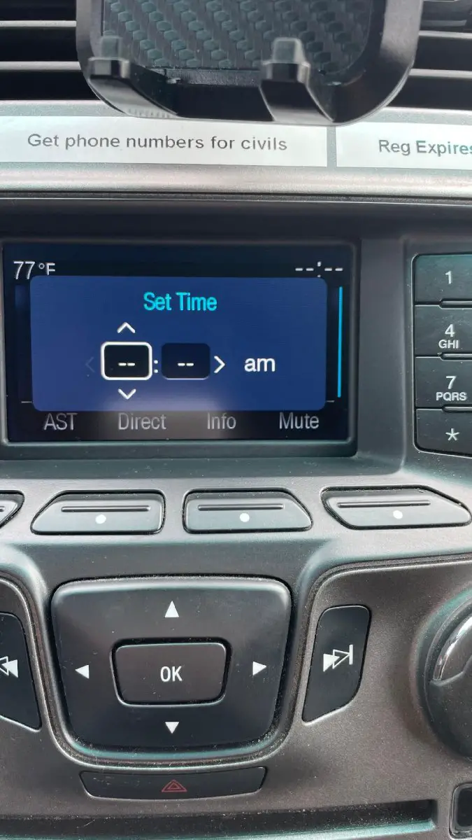

So I replaced the screen and now I have a clock issue on my 2015 PIU. Before this issue the numbers would already be present and I had the ability to change them, now no numbers. Please help.
Is it the same part number that you replaced it with? If not you may need to pull the asbuilt data from forescan and re-write it onto the new module.
I couldn’t even find the section to fix in forscan. The Dealer was also no help.
