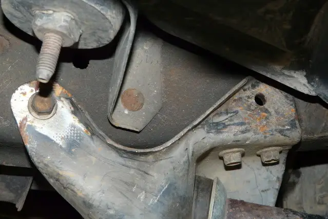

It's these puppies...
This picture is of my passenger side one. This is the bracket, but you can see the bushing down there in the bottom of the picture. There is one about right under the front part of the doors on both sides.

Wow no rust, I want to live in arizona where nothing rusts. My 92's frame is so rusty you cannot tell where the rivets are. The body is another automotive atrocity.:(
Hey, thank you for askin' the question I needed an answer to , I am not mechanicly inclined nor do I posess a degree in engineering , LOL. I am hearing the same noise and checked my radius arm bushings and I see some wear around the bracket.
