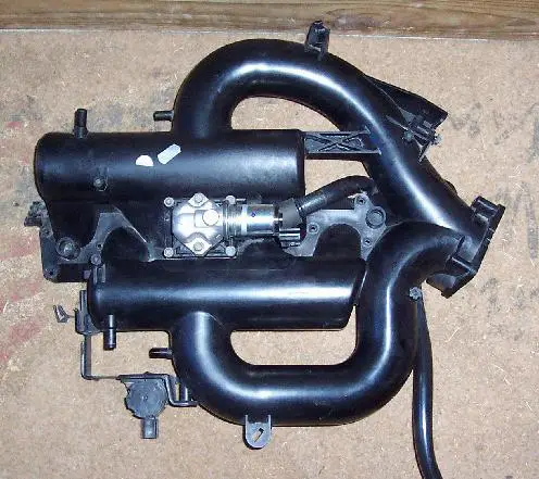

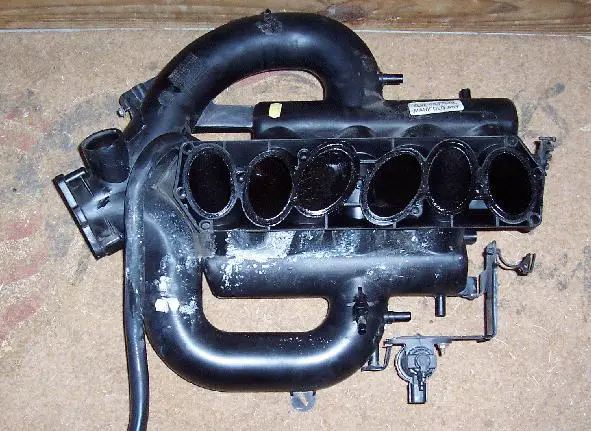

Since I frequently suggest checking vacuum hoses and lines I probably should try and list them. I'll start a list here and eventually generate a thread with photos identifying the listed items.
The photos below will help me list the lines.
1. top left: power brake booster
2. top center: PCV valve "T"
3. bottom center: PCV valve "T"
4. bottom left: (splits into three lines with two lines splitting again into two) fuel pressure damper, EGR vacuum regulator, evaporative emission canister purge valve, vacuum reservoir bulb below air filter enclosure
5. center: IAC valve inlet (short flexible hose and rigid tube)
6. top center: fuel vapor management valve (T connection with 7 below at front of engine)
7. bottom center: fuel vapor management valve (T connection with 6 above at front of engine)
