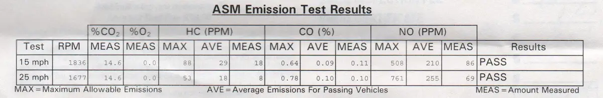

Alrighty more results to share. Cleared the computer and managed to get it smogged before the light came back on.
Results: Pass with flying colors
The new DPFE fixed the 332 code as of right now. But I'm still getting the 176 and pinging under heavy load, so still have some work to do.
Seeing as its pinging I'm pretty confident that the O2 is seeing a real lean event, as old as the sensor may be. Puzzling thing is, if it were actually running lean wouldn't I see much worse numbers?
Your Hydrocarbons are 10 PPM below average, the engine is in fact running lean.
