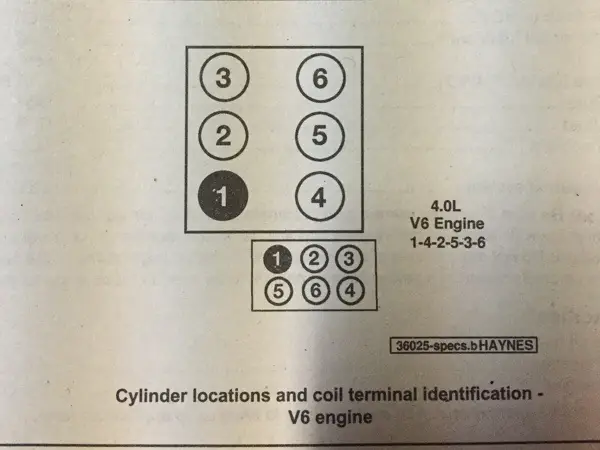

someone removed the coil pack and the new 1 has no # I have the 2001 explorer sport trac . please help
Here you go.
